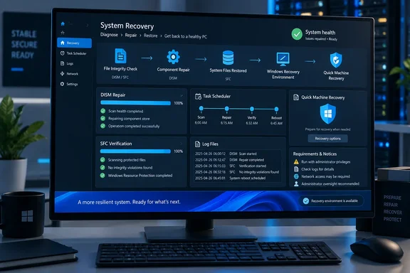

A monitor displays a Windows system recovery dashboard showing completed repairs and healthy system status.
