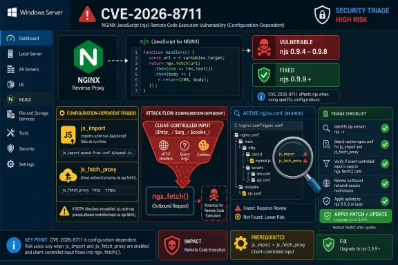

Start With the Exact Exposure Pattern
CVE-2026-8711 is best understood as a configuration-dependent njs problem. The affected component is NGINX JavaScript, commonly called njs. The vulnerable versions are 0.9.4 through 0.9.8. The fixed threshold is 0.9.9 or later.The issue requires more than old software. The risky pattern is:
- NGINX imports JavaScript with
js_import. - njs is in the vulnerable range, 0.9.4–0.9.8.
js_fetch_proxyis configured.js_fetch_proxyuses at least one client-controlled NGINX variable, such as request headers, query arguments, or cookies.- A location invokes njs code that uses
ngx.fetch().
The practical impact is also specific. The primary risk is denial of service: crafted unauthenticated requests may crash NGINX worker processes, causing restarts and service instability. The more severe but narrower concern is conditional remote code execution, where exploitation depends on memory-protection circumstances such as ASLR being disabled or bypassed. Administrators should not describe every exposed instance as trivially RCE, but they also should not minimize unauthenticated memory corruption in an edge-facing worker process.

CVE-2026-8711 is easy for automated workflows to mishandle. The affected component has a clear version range, but the exploit path depends on active configuration and imported JavaScript behavior.That creates two common failure modes.
The first is over-ticketing. Every system with NGINX, or every image containing njs, gets marked urgent even when the active configuration has no
js_import.The second is under-response. Teams close the issue because the host is “only a proxy” or because the NGINX instance is not part of the main Windows patch workflow, even though it exposes internal services to unauthenticated traffic.
A good ticket should include evidence, not just a CVE label. For example:
Code:
Instance: edge-proxy-01
Active config: C:\nginx\conf\nginx.conf
njs version: 0.9.8
js_import: present
js_fetch_proxy: present
Client-controlled variables: $http_*, $arg_target
ngx.fetch(): present in imported njs file
Status: in scope; upgrade required to njs 0.9.9+
Code:
Instance: app-proxy-02
Active config: C:\Program Files\Vendor\Product\nginx\conf\nginx.conf
js_import: not present
Status: out of scope for CVE-2026-8711 njs JavaScript path
Put a Small Gate in the Rollout Pipeline
The best long-term response is to turn the triage into a deployment gate. Before promoting an NGINX image, vendor bundle, reverse-proxy configuration, or infrastructure release, check for the risky combination.A minimal gate should verify:
- The njs version from the actual runtime or image.
- Whether
js_importappears in the active NGINX configuration. - Whether
js_fetch_proxyappears in active configuration files. - Whether imported JavaScript files contain
ngx.fetch(). - Whether
js_fetch_proxyreferences client-controlled variables such as$http_*,$arg_*, or$cookie_*.
The key is to avoid a brittle control that only asks, “Does the scanner mention CVE-2026-8711?” This issue is contextual. The control should be contextual too.
What to Put in the Change Ticket
A useful remediation ticket should be specific enough for handoff. It should say:- The affected component is NGINX JavaScript njs, not generic NGINX.
- Vulnerable versions are 0.9.4 through 0.9.8.
- The fixed version is 0.9.9 or later.
- The issue is generally out of scope when no active
js_importexists. - The risky pattern involves
js_fetch_proxy, client-controlled variables, andngx.fetch().
Code:
Action: Upgrade njs to 0.9.9 or later.
Validation:
- Confirm active NGINX config path.
- Confirm njs runtime version.
- Confirm whether js_import is present.
- Confirm whether js_fetch_proxy references $http_*, $arg_*, or $cookie_*.
- Confirm whether imported njs files use ngx.fetch().
- Regression-test routing, headers, authentication handoff, logging, health checks, and worker stability.
js_fetch_proxy input during the rollback window. A compensating configuration change is safer than hoping the exposed path is not discovered.Treat Edge JavaScript as Infrastructure Code
njs sits in an awkward category. It looks like application code because it is JavaScript. It behaves like infrastructure because it runs inside the request path of the web server. That makes ownership easy to blur.Application teams may not review it because it is “NGINX configuration.” Infrastructure teams may not review it deeply because it is “JavaScript.” Security teams may see only the resulting deployment after the proxy is already in production.
CVE-2026-8711 is a reminder that this split is risky. If njs is part of a production edge path, it should have:
- A known repository or source of record.
- Reviewers.
- Change history.
- Tests for supported routing and fetch behavior.
- Validation for client-controlled input.
- A deployment trail.
- Ownership that is clear before an incident.
Patching to njs 0.9.9 or later closes this known issue. Treating njs as infrastructure code reduces the chance that the next configuration-sensitive issue turns into an emergency.
Practical Read Before the Next NGINX Rollout
Before the next NGINX rollout, use this condensed checklist:- Identify the active NGINX instance and configuration path.
- If NGINX runs as a Windows service, read the service
PathName. - If NGINX runs in a container, inspect mounts and search inside the container if needed.
- If NGINX runs in WSL, inspect the Linux-side
/etc/nginxconfiguration. - If NGINX is vendor-bundled, start from the service path or product supervisor path.
- Search the active configuration tree for
js_import. - If there is no
js_import, document that the JS-specific issue is generally out of scope. - If
js_importexists, confirm the deployed njs version. - Treat njs 0.9.4–0.9.8 as vulnerable.
- Treat njs 0.9.9 or later as the fixed threshold.
- Search for
js_fetch_proxy. - Check whether it uses
$http_*,$arg_*,$cookie_*, or other client-influenced values. - Search imported JavaScript for
ngx.fetch(). - If the full risky pattern exists, upgrade njs and regression-test the edge path.
- After patching, refactor configurations that let untrusted request data steer proxy behavior without strict validation.
js_fetch_proxy, and know whether ngx.fetch() is in the request path.Frequently Asked Questions
Does CVE-2026-8711 affect all NGINX servers?
No. It affects NGINX JavaScript njs under a specific vulnerable version and configuration pattern. A basic NGINX reverse proxy with no activejs_import is generally outside this JS-specific issue.What versions are vulnerable?
The vulnerable njs versions are 0.9.4 through 0.9.8. The fixed threshold is 0.9.9 or later.What is the fastest way to decide whether a Windows-hosted NGINX instance is in scope?
