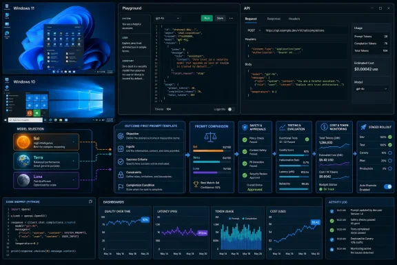

Rewrite a prompt around the outcome
An outcome-first prompt should answer four questions:- What result must the model produce?
- What inputs and tools may it use?
- What constraints must it obey?
- What conditions indicate that the task is complete?

Use a reusable outcome-first template
The following template works for many API and agent tasks:
Code:
Objective:
[Describe the result to produce.]
Context and inputs:
[List the supplied files, records, variables, or user information.]
Success criteria:
- [Requirement 1]
- [Requirement 2]
- [Requirement 3]
Constraints:
- [Actions or sources that are permitted]
- [Actions that require approval]
- [Actions that are prohibited]
- [Required output format]
Completion condition:
Stop when [the result has been produced and verified].
If completion is impossible, return [the required failure or escalation result].

Select the appropriate GPT-5.6 model
Start with the model that meets the task’s quality requirement, then test whether a less expensive model can pass the same evaluation.Use
gpt-5.6-sol when the workload involves:- Complex coding or debugging
- Long-running professional work
- Ambiguous evidence
- Multiple tools or dependencies
- High-value decisions requiring stronger reasoning
gpt-5.6-terra when you need a balance between quality and cost, including routine document processing, support triage, extraction, summarization, and structured business workflows.Use
gpt-5.6-luna for focused, high-volume tasks such as classification, routing, normalized extraction, and straightforward transformations. Do not select Luna solely because it has the lowest token price; verify that it meets the required accuracy threshold.OpenAI lists the standard per-million-token rates as:
- Sol: $5 input and $30 output
- Terra: $2.50 input and $15 output
- Luna: $1 input and $6 output
Test the new prompt in the Playground
The OpenAI Playground provides the safest way to compare prompts without immediately changing application code.- Open the OpenAI platform in a supported Windows browser.
- Select the same organization and project used by the application.
- Open the Playground.
- Select the Responses API configuration if the application uses Responses.
- Choose the production model, such as
gpt-5.6-terra. - Match the application’s reasoning effort and tool configuration.
- Paste the original prompt.
- Run a representative test case and save the output and usage information.
- Replace only the prompt with the outcome-first version.
- Run the identical test case again.
- Repeat the comparison across normal, difficult, incomplete, and adversarial inputs.
