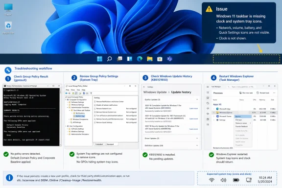

Start with the exact symptom
Use the visible symptom to choose the first policy to inspect.| Symptom | Inspect first |
| Clock alone is missing | Remove Clock from the system notification area |
| The notification area is hidden | Hide the notification area |
| Quick Settings cannot be opened from the taskbar | Remove Quick Settings |
| Only network, volume, or battery is missing | The corresponding removal policy, where supported |
| Quick Settings opens with a restricted layout | The separate Simplify Quick Settings policy |
| Entire taskbar is blank, frozen, or repeatedly reloads | Windows Explorer and shell troubleshooting |
| Only one user is affected | Effective user policy and that user’s assigned configuration |
| Multiple users are affected | Shared configuration and Windows shell troubleshooting |
Confirm the update and record the build
- Press Windows key + R.
- Enter:
winver- Select OK.
- Record the Windows version and OS build.
- Open Settings > Windows Update > Update history.
- Expand Quality Updates.
- Confirm whether KB5101650 is installed.
- Record its installation date.
Generate the effective policy report as the affected user
The report must be generated in the affected user’s sign-in session. Do not launch Command Prompt with another administrator’s credentials: doing so can make%USERPROFILE% and the reported user context refer to the administrator rather than the affected user.For the affected user’s normal user-policy results, elevation is not required:
- Sign in as the affected user.
- Open Start.
- Type
cmd. - Open Command Prompt normally.
- Run:
gpresult /h "%USERPROFILE%\Desktop\gp-report.html" /scope user- Wait for confirmation that the report was saved.
- Open gp-report.html from the affected user’s desktop.
- Search for:
- Remove Clock from the system notification area
- Hide the notification area
- Remove Quick Settings
- Remove the networking icon
- Remove the volume control icon
- Remove the battery meter
- Also search for
clock,notification area,Quick Settings,network,volume, andbattery. - Record any displayed policy source information.
gpresult /h "%PUBLIC%\Desktop\gp-computer-report.html" /scope computerIf alternate administrator credentials are required for elevation, do not treat that elevated process as a report of the affected user’s identity.

Inspect the documented user policies
Where Local Group Policy Editor is available:- Press Windows key + R.
- Enter:
gpedit.msc- Select OK.
- Go to:
- Locate the policies associated with the observed symptom.
- Record whether each policy is Enabled, Disabled, or Not Configured.
For the documented notification-area policy, enabling Hide the notification area hides that area, including its notification icons. Disabling it or leaving it not configured allows the notification area to be shown.
Microsoft’s Start policy reference provides the supported scope, editions, and behavior for Start and taskbar-related policy settings. Use the entry for each policy rather than assuming that similarly named clock, icon, and Quick Settings controls have identical requirements.
Treat the names as diagnostic signposts:
- For a missing clock, inspect Remove Clock from the system notification area.
- For a hidden tray region, inspect Hide the notification area.
- For a missing Quick Settings entry point, inspect Remove Quick Settings.
- For one missing status indicator, inspect the corresponding policy if it is present and supported on the affected Windows edition.
Simplify Quick Settings is a separate control
Simplify Quick Settings is a separate GPO/CSP-controlled setting. Consider it only when Quick Settings still opens but presents a restricted layout. Do not use it to explain a missing clock or an entirely absent notification area unless the organization’s policy records identify that setting.Correct an identified policy through management

Test Windows Explorer
If the effective policy does not account for the symptom, restart Windows Explorer and observe the result:- Press Ctrl + Shift + Esc to open Task Manager.
- Find Windows Explorer under Processes.
- Right-click Windows Explorer.
- Select Restart.
- Wait for the desktop and taskbar to reload.
- Test all previously missing components.
- Record whether the components returned and whether they remained available.
An Explorer restart result is evidence for the escalation packet; by itself, it does not identify the underlying cause.
Perform an approved rollback test
If the organization approves uninstalling KB5101650 on a test device, use the supported Settings route:- Preserve the current OS build and effective-policy reports.
- Open Settings.
- Select Windows Update.
- Select Update history.
- Select Uninstall updates.
- Locate KB5101650.
- Select Uninstall.
- Restart when prompted.
- Run
winverand record the resulting build. - Verify every previously missing tray component.
- Generate another affected-user policy report.
- Record whether the symptom changed.
