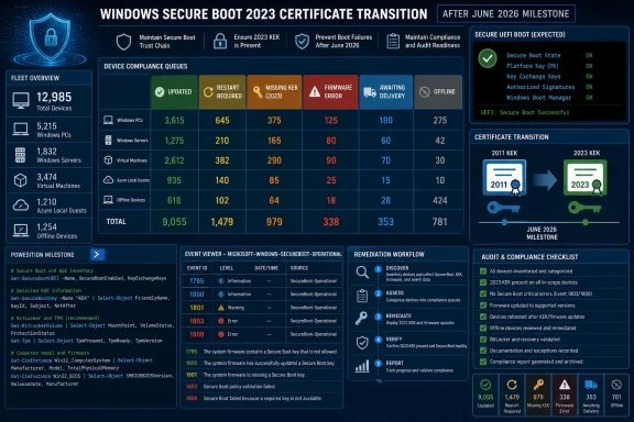

Apply the first-pass decision table
Microsoft’s Secure Boot event guidance provides the 1800, 1801, 1803, and 1795 interpretations used here. Apply the rules in this order:| Current evidence | Queue |
UEFICA2023Status=Updated | Updated |
Event 1800 or 1801 and status is not Updated | Restart required |
Event 1803 and status is not Updated | Missing KEK |
Event 1795 and status is not Updated | Firmware error |
Reachable, eligible, not Updated, and no event above explains the state | Awaiting phased delivery |
| Device cannot be contacted | Offline |
