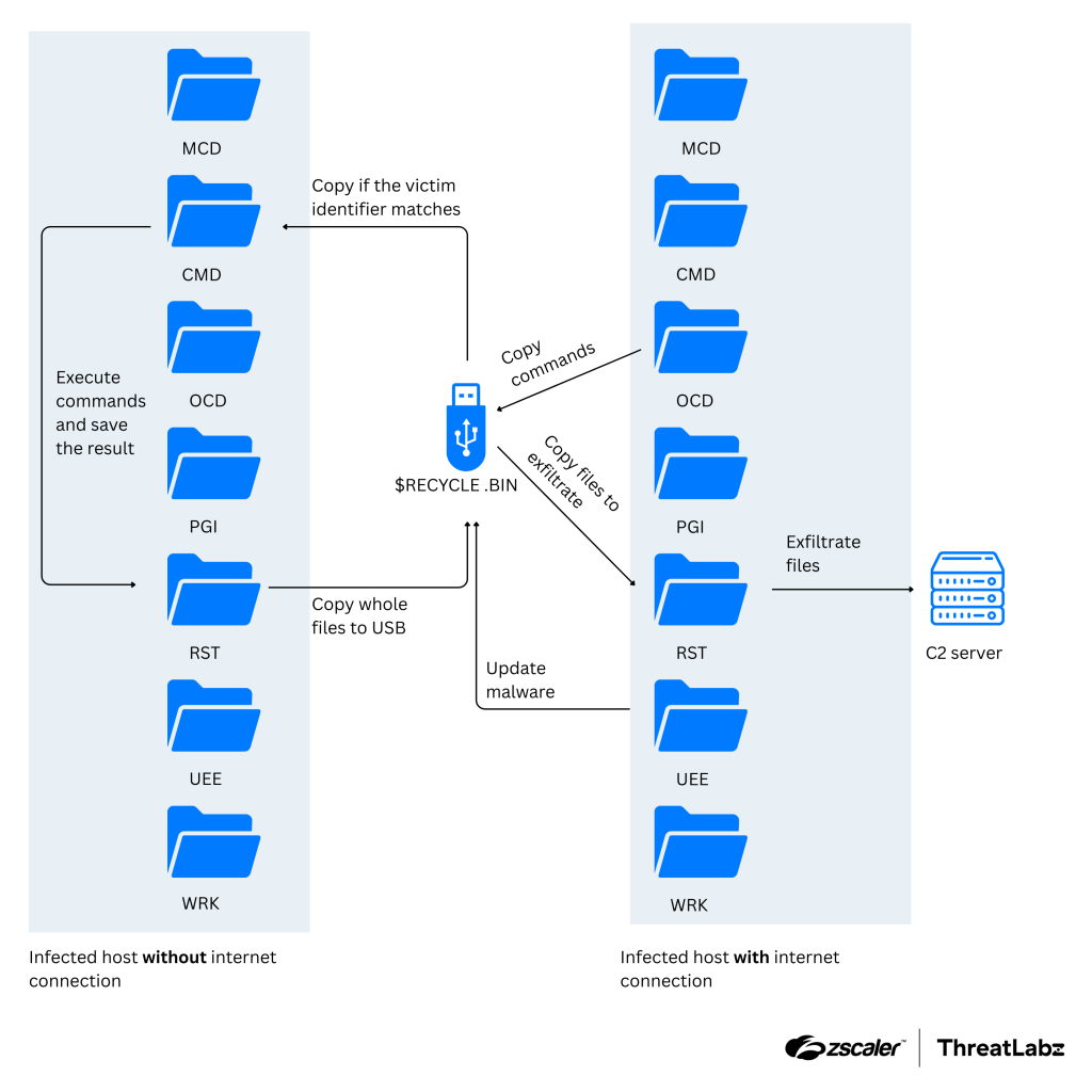

Honeywell’s 2024 USB Threat Report found that 51 percent of malware observed in its industrial USB telemetry was designed to spread via USB, up from 9 percent in 2019. That is the sort of statistic that should end the casual use of “air-gapped” as a synonym for “safe.” Attackers have followed the workflow.
The reason is obvious: USB sticks are not edge cases in OT. They are how files move when networks do not. They carry patches, reports, PLC logic, configuration exports, antivirus updates, license files, and vendor diagnostics.

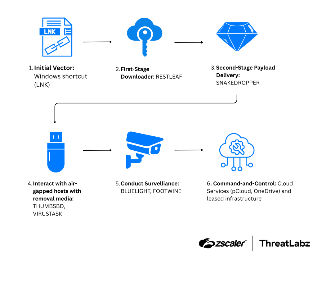

Threat researchers have repeatedly documented campaigns built around this reality. Zscaler ThreatLabz reported that North Korea-linked APT37 used USB-capable implants to reach air-gapped systems. ESET documented GoldenJackal tooling against air-gapped government targets in Europe between 2022 and 2024. Kaspersky has reported APT31-linked activity aimed at industrial organizations in Eastern Europe, including implants designed to abuse removable drives.
None of this requires cinematic hacking. It requires patience, logistics, and an understanding of how industrial maintenance actually works. A contractor laptop, a vendor update package, a shared engineering workstation, or an undocumented wireless interface can become the bridge.
