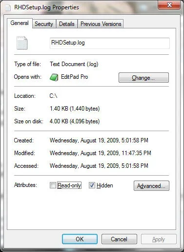

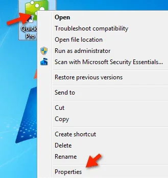

When you right-click on one of those files and select properties, what does it say about it?
Change opens with to use a media player.
An image from 'All video files have turned into .pptx files'. Right-clicking a file to access Properties, showing file open with EditPad Pro.
