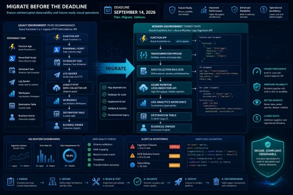

Azure Functions 1.x and the Azure Monitor HTTP Data Collector API share a September 14, 2026 support deadline, so teams should treat any workload that uses both as one dependency problem: identify the function, its sender, its log destination, and its owner before changing either runtime or ingestion.
Microsoft lists September 14, 2026 as the end-of-support date for Azure Functions 1.x and recommends moving function apps to version 4.x. The same date ends support for the legacy HTTP Data Collector API, with Microsoft directing customers to the Logs Ingestion API. As WindowsForum members noted in the Data Collector API retirement discussion, the immediate risk is often not the Azure Monitor Agent or a single visible function app. It is an overlooked PowerShell script, scheduled task, or deployment utility that still sends custom logs through the old collector path.
That makes this a workload decision, not two routine settings changes. A function can be upgraded to version 4.x and still rely on the retiring logging API. Conversely, a logging sender may remain outside Functions entirely. The useful first deliverable is a joined dependency register that connects runtime, sender, destination table, and business owner.
Create one inventory for both migrations. For every function app, record its subscription, resource group, owner, purpose, trigger, repository or deployment location, current runtime setting, and whether it sends logs directly or calls a component that does. Then connect that app to the workspace, table, sender identity, and downstream queries that depend on its telemetry.

The deadline is fixed, but the migration sequence should be deliberate: inventory the real callers, connect each Function app to its log flow, select modernize/replatform/retire outcomes, build the DCR-based destination, and cut over only when the agreed evidence proves that both execution and observability still work.
Start With One Joined Inventory
Create one inventory for both migrations. For every function app, record its subscription, resource group, owner, purpose, trigger, repository or deployment location, current runtime setting, and whether it sends logs directly or calls a component that does. Then connect that app to the workspace, table, sender identity, and downstream queries that depend on its telemetry.Use this WindowsForum inventory example to find apps whose

Choose the Function Outcome Before Changing the Runtime
Microsoft states that Azure Functions currently supports version 4.x of the runtime host and that version 1.x support ends on September 14, 2026. Do not assume every version 1.x app should be carried forward unchanged.Use three outcomes:
- Modernize when the function has an active owner, a current business purpose, a deployable codebase, and a test that proves its trigger and output.
- Replatform when the workload should continue but its current Function app is not the right operating boundary. This is a decision based on ownership, deployment, and operational requirements—not a claim that a particular workload category must leave Functions.
- Retire when the business owner confirms that the output is unused or duplicated and the team has checked alerts, workbooks, saved queries, and downstream processes.

The HTTP Data Collector API is retiring, and Microsoft directs customers to the Logs Ingestion API. Microsoft also describes the new approach as DCR-based: a data collection rule defines incoming data, transformations, and destination Log Analytics tables. That is why this work is an architecture change rather than a URL replacement.For each sender, document:
- The JSON fields sent today.
- The destination workspace and table.
- The fields that operators, alerts, workbooks, and queries must retain.
- The target table and incoming stream design.
- The DCR that applies the transformation and sends data to the table.
- The sender update, test owner, and rollback owner.
For automation, use Azure CLI to create the DCR from a reviewed JSON definition:
Code:
az monitor data-collection rule create \
--resource-group <resource-group> \
--name <dcr-name> \
--location <region> \
--rule-file <reviewed-dcr-definition.json>
Then update the sender to use the Logs Ingestion API configuration associated with that DCR. Keep the sender change separate from the DCR creation change so that failures can be isolated: first prove the destination design, then prove the revised sender, then prove the application or Function that invokes it.
The supplied Microsoft guidance establishes that DCRs govern incoming data, transformations, and destination tables. It does not support treating every implementation detail as universal. In particular, do not assume that an existing table can be converted in place, that a rollback behaves a particular way, that side-by-side tables are always supported, or that a particular endpoint or authorization arrangement applies to every environment without checking the current Microsoft documentation for the specific DCR and network design.
Cut Over With Measurable Dual-Write Criteria
Where the old and new senders can run safely in parallel, dual-write is the strongest validation method. Send the same representative events through the legacy collector and the new ingestion path for an approved test period. Compare results before disabling the old sender.Acceptance criteria should be explicit:
- The Function app or other sender completes its expected trigger or job successfully.
- The new destination receives the expected test records.
- Required fields are present and queryable in the destination table.
- Timestamp handling is acceptable for the operational queries that consume the data.
- The alert, workbook, and saved-query owner validates the updated query against new data.
- The sender’s owner and observability owner approve the comparison.
- A rollback owner can restore the previous approved application deployment if the sender or function fails validation.
After approval, the cutover owner disables the legacy sender and documents the new DCR, destination table, sender implementation, and accountable support owner. Keep the old configuration only as long as the approved rollback plan requires it. The final dependency register should show that every former Data Collector API caller has either moved, been retired, or been accepted as an explicitly managed exception.
