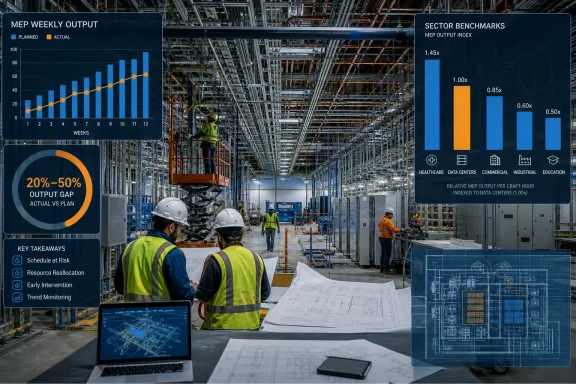

The First MEP Finding Should Prompt a Planning Review
The Lab’s most striking initial result is the reported 20% to 50% difference between planned and actual weekly MEP output on data-center projects.That range deserves attention because it compares the production rate placed in the plan with the rate observed in execution. It does not, by itself, establish why the difference occurred. The supplied launch facts do not identify whether the gap resulted from planning assumptions, labor availability, access, design status, logistics, sequencing, materials, rework, measurement choices, or a mixture of factors.
Any explanation of the cause is therefore analysis, not a reported conclusion.
One plausible interpretation is that some weekly plans may have relied on output assumptions that were difficult to sustain. Other explanations are also possible: actual work may have faced constraints that were not present when the plan was prepared, or the planned and observed quantities may have been affected by project-phase and classification choices. The aggregate range cannot distinguish among those possibilities for an individual project.
The appropriate management response is not to conclude automatically that field teams underperformed or that planners produced an unrealistic schedule. It is to test the project’s production assumptions.
A project team can begin by identifying the quantity of work expected each week, the crews and workfaces needed to deliver it, and the conditions assumed to be available. It can then compare those assumptions with current performance, its own completed-project evidence, and the most relevant external cohort Buildots can provide.
That review should lead to a precise decision: Is the planned weekly MEP rate credible under the project’s documented operating conditions, or should the plan, resources, sequence, or constraints be changed?
The finding may be especially relevant to data-center teams because MEP installation sits on the route toward testing, commissioning, and operational readiness. It would be speculative to claim that the reported output gap necessarily causes commissioning delay. However, project leaders can reasonably examine whether a sustained shortfall would reduce the time available for later activities on their particular schedule.
The range should also be used carefully in commercial discussions. An aggregate result may justify asking harder questions about a proposed production rate. By itself, it does not establish the correct rate for a particular subcontractor, geography, system, building area, or project phase.
The Sector Ordering Is a Starting Point, Not a League Table
Buildots’ first findings also place healthcare projects at the top of the sectors studied for average schedule adherence. Data centers followed, while commercial, industrial, and education projects recorded lower adherence.The ordering is newsworthy, but it should not be interpreted as a general judgment about the competence of teams in those sectors. A sector average can combine projects with different scopes, locations, delivery models, phases, schedule structures, and reporting practices.
The launch facts establish the ordering. They do not establish its causes.
It is possible that healthcare results are influenced by coordination practices, regulatory controls, or repeatable specialist workflows, but those are analytical hypotheses that would require additional evidence. Likewise, lower adherence in another sector could reflect project characteristics, planning conventions, data coverage, activity definitions, or execution constraints. The published ordering alone cannot determine which explanation is correct.
The relationship between the two initial findings also deserves careful handling. Data centers ranked behind healthcare in average schedule adherence while also showing a substantial planned-versus-actual weekly MEP-output gap. These findings are not necessarily inconsistent because they may measure different dimensions of performance.
A project could maintain a comparatively high share of planned activities while producing less MEP quantity per week than expected. It could also install significant quantities while completing work in a sequence that differs from the schedule. Possible explanations include resequencing or differences in activity structure, but the launch facts do not establish that either occurred in the projects studied.
For readers, the useful question is not simply which sector ranked first. It is whether the differences remain after projects are divided into appropriate cohorts and whether Buildots can identify practices or conditions associated with stronger results.
