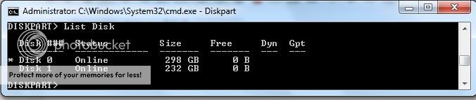

I have posted the answer to this before but can't recall the thread. But you may try this:
  1. Click Start and in Search programs and files box type CMD
  2. From top of Start menu under Programs (1) RIGHT-click CMD> Run as administrator
  3. At the Command prompt (>) type Diskpart and press [ENTER]
  4. Type List Disk [ENTER]
  5. Type Select Disk N ( N = your Disk Number) [ENTER]
  6. Type List Partition [ENTER]
  7. Select Partition n (n=the partition you want) [ENTER]
  8. TypeAssign [ENTER]
Hope this helps to assign the drive letter

I need to assign a letter to disk 0
These steps work for me :). Thanks.
