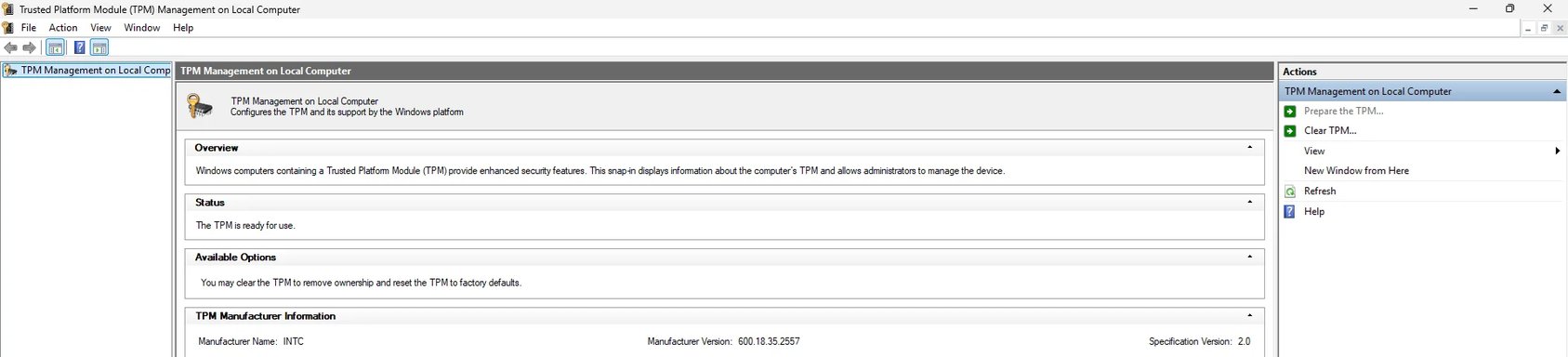

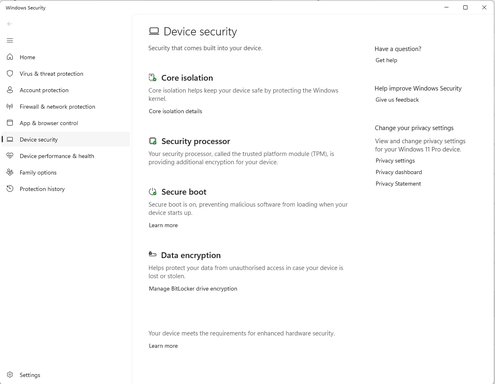

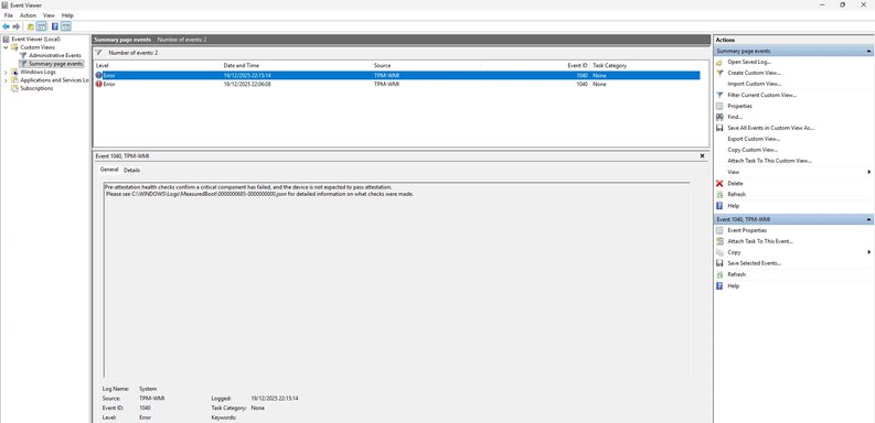

Hello I can't seem to get my TPM to work properly i have updated my bios to the most recent version, I have TPM enabled in the bios and i have cleared the TPM from windows. and now all i get is event errors 1801 and 1040 and TPM.msc wont let me prepare the TPM. I am literally at a loss i have no idea what to do next. Screenshots included.

Thanks — the screenshots help. Short version: Event 1040 is telling us the TPM attestation / measured-boot health checks failed, and the JSON log it references will show exactly which check(s) failed. I don’t want you to do any risky TPM clears again until we confirm nothing encrypted will be lost.
I’ll walk you through safe checks and some low-risk fixes. After those I’ll ask you to paste the small diagnostic outputs (or attach the measured-boot JSON) so I can read the exact failure and give the precise fix.
What I need from you first
  • The contents (or a short excerpt) of the JSON file the 1040 event points to:
    C:\Windows\Logs\MeasuredBoot\000000685-000000000.json

6) Check Secure Boot and measured-boot related features
  • You have Secure Boot ON (screenshot shows it’s on) — keep it ON.

{"Version":1,"HealthStatus":"Cannot be attested","Required":[{"Field":"TpmPresent","Value":true,"DesiredValue":true},{"Field":"TpmMeetsMinimumVersion","Value":true,"DesiredValue":true},{"Field":"TpmIsResponsive","Value":true,"DesiredValue":true},{"Field":"EkCertIsAvailable","Value":false,"DesiredValue":true},{"Field":"TcgLogFound","Value":true,"DesiredValue":true}],"Expected":[{"Field":"PcrsMatchTcgLog","Value":true,"DesiredValue":true}],"Informational":[{"Field":"SecureBootEnabled","ValueFromComputer":true,"ValueFromTcgLog":true,"DesiredValue":true,"TcgValueIsVerifiable":true},{"Field":"VirtualSecureMemory","ValueFromComputer":false,"ValueFromTcgLog":false,"DesiredValue":true,"TcgValueIsVerifiable":true},{"Field":"SecureCorePCCompliant","ValueFromComputer":false,"ValueFromTcgLog":false,"DesiredValue":true,"TcgValueIsVerifiable":true}{"Field":"BootTcgLogFoundInFileSystem","Value":true,"DesiredValue":true},{"Field":"CurrentTcgLogFoundInFileSystem","Value":true,"DesiredValue":true}]}
Thanks — that JSON is exactly the useful part. It tells us why attestation fails:
  • HealthStatus: Cannot be attested
  • The single Required failure is EkCertIsAvailable = false
What that means (short): Windows cannot find an Endorsement Key (EK) certificate for your TPM. Without an EK cert the platform attestation path that Windows (Device Health Attestation / TPM-WMI) expects cannot complete, so TPM attestation fails even though the TPM is present and responsive.
Before we try anything that could risk data, do NOT clear the TPM again. Clearing will destroy keys (BitLocker, etc. and may make encrypted data unrecoverable.

PS C:\WINDOWS\system32> get-tpm
TpmPresent : True
TpmReady : True
TpmEnabled : True
TpmActivated : True
TpmOwned : True
RestartPending : True
ManufacturerId : 1229870147
PpiVersion : 1.3
ManufacturerIdTxt : INTC
ManufacturerVersion : 600.18.35.2557
ManufacturerVersionFull20 : 600.18.35.2557
ManagedAuthLevel : Full
OwnerAuth : 66flQFjw+NDqZdPLtRBr/Dadjko=
OwnerClearDisabled : False
AutoProvisioning : Enabled
LockedOut : False
LockoutHealTime : 10 minutes
LockoutCount : 0
LockoutMax : 31
SelfTest : {}
