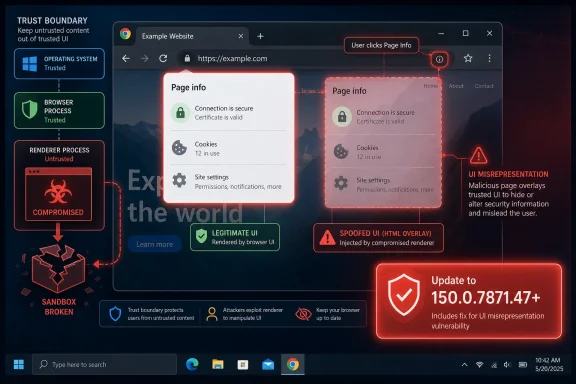

Diagram shows browser trust boundaries blocking malicious UI overlay while updating to fix a vulnerability.The Browser’s Smallest Trust Signal Becomes the Story​
PageInfo is not glamorous browser plumbing. It is the little identity-and-permissions surface users reach when they click the icon near the address bar to inspect connection security, site permissions, cookies, certificates, and related state. In a modern browser, that UI is supposed to sit on the user’s side of the glass, not the website’s.
CVE-2026-13989 matters because it lives precisely at that boundary. The vulnerability description says a remote attacker needed a compromised renderer process first, which means this was not a standalone browser escape. But once that condition existed, the attacker could use crafted HTML to perform UI spoofing against PageInfo — a weakness categorized by CISA-ADP as CWE-451, “User Interface Misrepresentation of Critical Information.”
That distinction is the key to understanding the risk. Chrome’s multiprocess architecture assumes that web content is hostile and sandboxes renderers accordingly. PageInfo belongs to the browser’s trusted interface, and when that interface can be misrepresented, the attacker is not merely tricking a page; the attacker is borrowing the browser’s credibility.
This is why “medium severity” should not be read as “irrelevant.” The score is lower because exploitation requires user interaction and a prior renderer compromise. The security significance is higher because the flaw touches the human part of the security model — the moment when a user or admin checks what the browser is telling them and decides whether to proceed.
