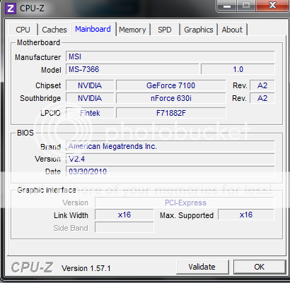

Im constantly getting BSOD's, mostly everyday, although while ive been researching the cause of it ive had about 5, which seems a bit weird. (all in space of an hour or so)
Im on windows 7 64bit, it should be noted that while i was running windows 7 32bit i had no such problems, maybe the occasional BSOD.
View attachment 052211-21106-01.dmp
Any help would be appreciated, let me know if you need anything else.

When ever i edit my post, it breaks it. Here are both attachments
(Actually the dump file is in the 1st post, there is a link which is inbetween the CPU-z screenshots)
