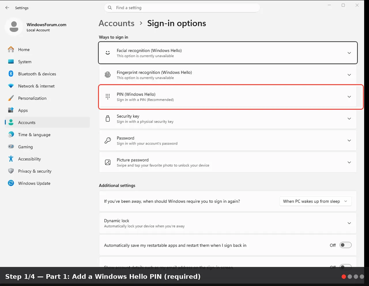

Part 1: Add a Windows Hello PIN (required)​
Windows 11 Settings on Sign-in options with the PIN (Windows Hello) section visible.
  • Open Settings
  • Press Win + I.
  • Go to Accounts
  • Click Sign-in options
  • Under Ways to sign in, select PIN (Windows Hello)
  • Click Set up (or Add)
  • Confirm your identity if prompted
  • You may be asked for your current password.
  • Create your PIN
  • Choose a PIN that’s not easily guessed (avoid 1234, birthdays, etc..
  • If you want, expand options (on some builds) to include letters and symbols.
  • Click OK
Tip: A PIN can be longer than 4 digits. A 6–10 digit PIN is a good balance between security and convenience.
