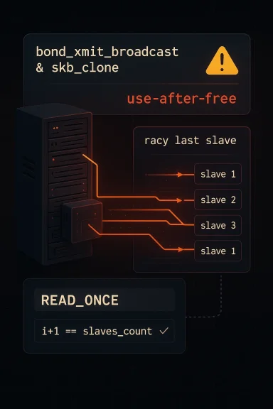

skb for the “last” slave and cloned it for the others. Under concurrent enslave and release activity, the slave list could change mid-iteration, which meant the identity of the last slave was no longer stable and the same packet could be consumed twice. That is a classic recipe for a use-after-free in a fast path that operators often assume is boring, deterministic plumbing.The key insight behind the fix is simple but important: the code should not decide “who is last” by re-evaluating a racy list state on every loop iteration. Instead, the patch snapshots the slave count once with READ_ONCE() and uses an index comparison,
i + 1 == slaves_count, to decide when to keep the original skb. That preserves the original zero-copy optimization for the final slave while removing the race window that could double-free the packet. In other words, this is not a redesign of bonding; it is a stabilization of a fragile assumption in a concurrency-sensitive path.What makes the CVE more interesting than its commit title suggests is that it lands in one of the most timing-sensitive areas of networking: packet replication for a bonded interface. Bonding is meant to improve resilience and throughput by letting multiple NICs act as one logical device, so failures here can ripple upward into storage traffic, virtualized workloads, clustered services, and any stack that depends on stable L2/L3 egress behavior. The presence of a KASAN crash trace showing
skb_clone() and bond_xmit_broadcast() is a strong hint that the bug is not theoretical, and the Linux kernel’s own CVE process explains why even issues with uncertain exploitability are routinely tracked once a fix is in hand. //www.kernel.org/doc/html/next/process/cve.html)

The published description of CVE-2026-31419 points to a classic use-after-free in the bonding driver’s broadcast transmission routine. The report says thatbond_xmit_broadcast() clones the original packet for some slaves and reuses the original for the final one, but its notion of “final” could shift because the slave list itself was mutable during RCU-protected traversal. The outcome was that the original skb could be double-consumed, which in kernel terms usually means eventual double free or a read from fx changes the decision point. Rather than repeatedly calling a helper that can be invalidated by concurrent membership changes, the code now compares the loop index to a pre-snapshotted slave count taken with READ_ONCE() before the loop starts. That is the right kind of fix for this class of bug because it reduces the problem to a stable arithmetic condition. The code still avoids an extra clone for the final recipient, but the final recipient is now defined against a consistent snapshot rather than a moving list.Why the old approach was racy
The old logic effectively asked a question whose answer could become obsolete before the next instruction executed. In a quiet system, that may be harmless. Under active slave changes, it becomes a race between list mutation and packet ownership decisions. RCU protects readers from some categories of structural corruption, but it does not magically make mutable membership lists immutable for application logic. That distinction is easy to miss when the code “looks” safe because it sits inside an RCU read-side section.The bug is especially nasty because the broadcast path is optimized around ownership transfer. Reusing the original
skb is legal only if exactly one recipient gets it. If the last-slave decision becomes stale, the same packet can be treated as both reusable and clone-worthy in different iterations. That is the sort of logic error that quickly turns into a memory safety bug even if the original code never explicitly frees anything twice.Why the new approach is better
The fix’s use of a snapshot count is elegant because it lowers the number of moving parts. Instead of asking, “is this the last slave right now?” the code asks, “is this the last slave in the count I observed before I started?” That question can still be true even while membership changes occur elsewhere, because it no longer depends on the current list tail. For a fast path, that kind of determinism is gold.It also preserves a valuable optimization. The original packet can still be reused for one recipient, which avoids a needless clone and helps reduce transmit overhead. In networking code, fixes that preserve hot-path efficiency are usually much easier to accept upstream and much less likely to cause regressions. This one appears to be a clean substitution rather than a behavioral rewrite.
The crash signature matters
The crash evidence in the CVE entry is not generic; it points specifically toskb_clone() and then into bond_xmit_broadcast(). That is significant because skb_clone() assumes the underlying packet structure is still valid. A use-after-free there means the packet metadata was already compromised by the time the clone logic ran. In other words, the symptom is in the clone path, but the root cause is ownership confusion earlier in the broadcast loop.- The cast transmit** path, not just an edge-case helper.

Technical Root Cause bug is a mismatch between ownership semantics and list traversal semantics. The code reused the original skb for the last slave, but it determined “last” via a helper that depended on the current shape of the slave list. If a slave was added or removed while the loop was running, the helper’s answer could shift. That made the transmit path vulnerable to treating the same packet as if it were still available after it had already been transferred or freed.
RCU is not a magic shield
RCU is excellent for read-mostly data structures, but it does not make logic immune to change. Readers can traverse safely without taking a heavy lock, but if their algorithm depends on the exact ordering or cardinality of a set that may mutate, they must still anchor their decisions to stable state. That is the subtlety this CVE exposes.The old approach appears to have relied on a “last slave” predicate that was meaningful only if the list stayed stable long enough. In practice, bonding maintenance operations can happen at awkward times, and a transmit path may overlap with device management operations. If the code uses current list state to make a one-shot ownership decision, it can lose the race even when the traversal itself is RCU-safe.
Why double-free follows naturally
Once the sameskb is reused by more than one recipient path, ownership becomes ambiguous. One branch may believe it owns the packet and release it, while another branch still sees a pointer that appears live. When the second branch later touches or frees the object, the slab allocator and the packet helpers can trip over the already-freed memory. That is how a logic bug becomes a slab-use-after-free.This is why the bug is not merely an academic correctness issue. Packet objects are not value types; they carry reference counts, metadata, and a lifetime contract. Violating that contract can crash the kernel, corrupt networking state, or produce hard-to-debug side effects that only show up under stress.
Why the patch is narrowly scoped
The fix does not introduce a new locking scheme or a major refactor. It simply changes the condition used to decide when to reuse the original packet. That restraint is usually a good sign in kernel maintenance because it minimizes collateral damage. The fewer subsystems touched, the less chance of accidental regressions in the delicate networking stack.- The original bug is a lifetime/ownership problem.
