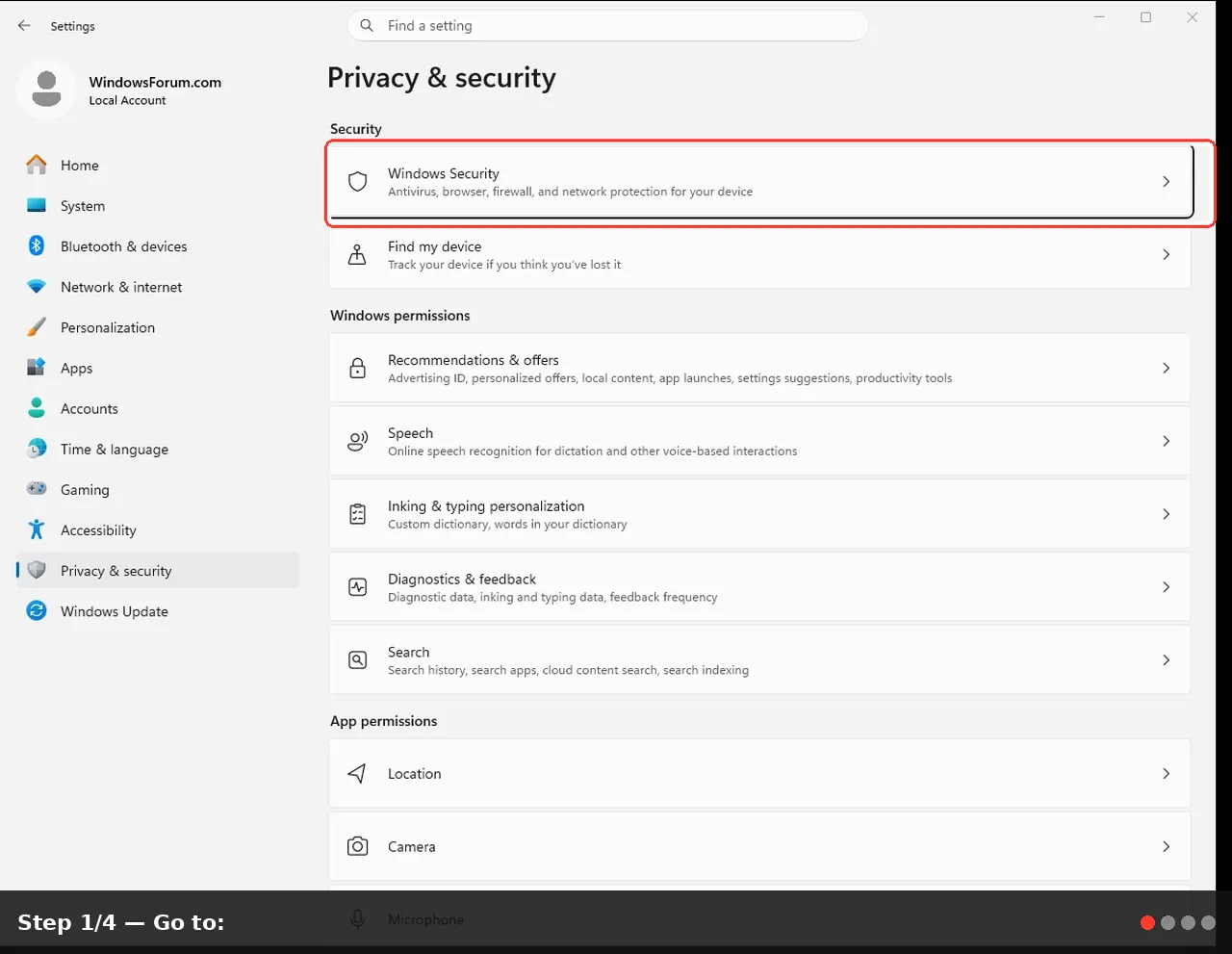

  • Press Win + I to open Settings.
  • Go to:
  • Windows 11: Privacy & securityWindows Security
  • Windows 10: Update & SecurityWindows Security
  • Click Open Windows Security.
  • Select Virus & threat protection.
Windows 11 Settings open on the Privacy & security page.
Note: If you see a message like “You’re using other antivirus providers,” Offline scan may not be available until Defender is active.
