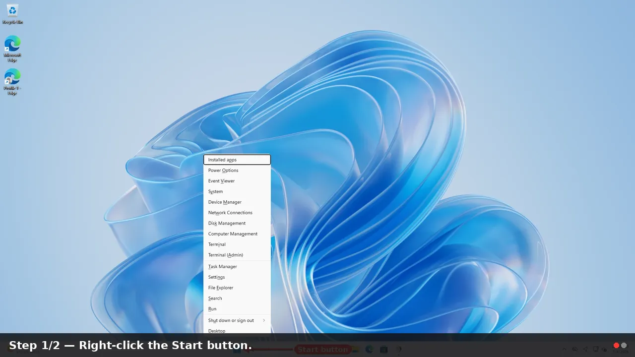

Step 1: Open PowerShell​
  1. Right-click the Start button.
  2. Select Terminal, Windows PowerShell, or Terminal (Admin) depending on your version of Windows.
  3. If you only need to fix scripts for your own user account, a normal PowerShell window is usually enough.
  4. If you plan to change the policy for all users on the PC, choose Run as administrator.
On Windows 11, Windows Terminal is commonly the default console host. It may open PowerShell, Command Prompt, or another shell depending on your settings. Make sure the tab says PowerShell.
