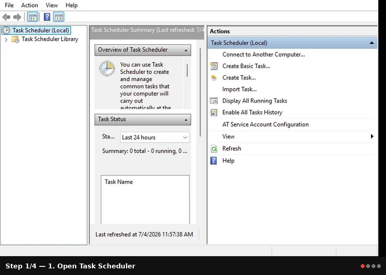

1. Open Task Scheduler​
Task Scheduler open on its main console with the Create Task action visible.
  • Press Windows + S to open Search.
  • Type Task Scheduler.
  • Select Task Scheduler from the results.
You can also press Windows + R, type taskschd.msc, and press Enter.
2. Choose “Create Task”​
Task Scheduler's Create Task dialog on the General tab with task name and security options.
Once Task Scheduler opens:
  • In the right-hand Actions pane, click Create Task.
Tip: You may also see Create Basic Task, but Create Task gives you more options and is better for apps, scripts, and backups.
