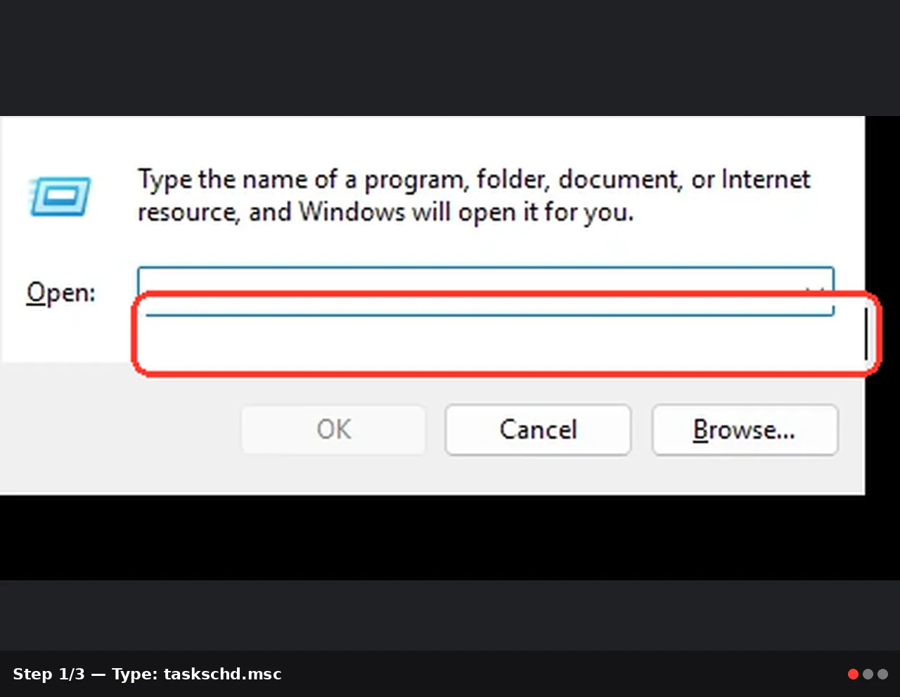

6) Open Task Scheduler
- Press Win + R
- Type:
taskschd.msc - Press Enter
