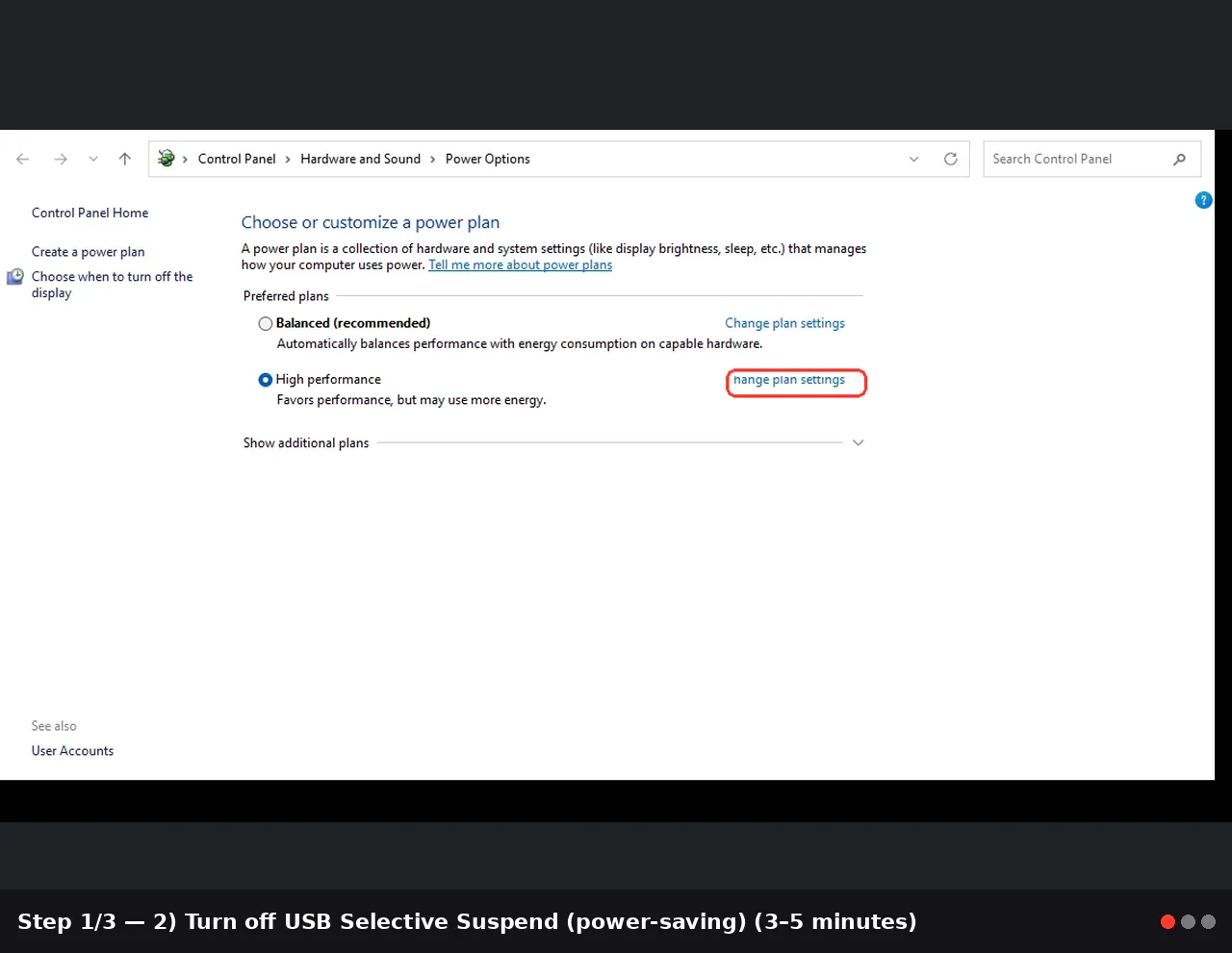

2) Turn off USB Selective Suspend (power-saving) (3–5 minutes)​
Power Options window for changing power plan settings.
Selective Suspend can cut power to devices and sometimes fails to wake them.
  • Press Win + R, type control, press Enter.
  • Go to Hardware and Sound → Power Options.
  • Next to your active plan, click Change plan settings.
  • Click Change advanced power settings.
  • Expand USB settings → USB selective suspend setting.
  • Set to Disabled for:
  • On battery (laptops)
  • Plugged in
  • Click Apply → OK.
