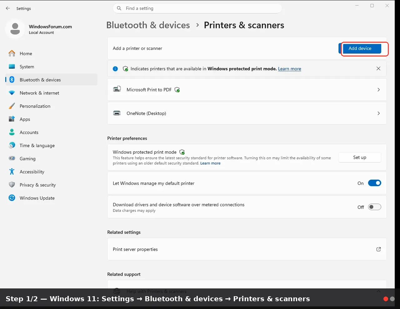

  • Go to:
  • Windows 11: Settings → Bluetooth & devicesPrinters & scanners
  • Windows 10: Settings → DevicesPrinters & scanners
  • Click your printer → Set as default (if available).
Windows 11 Settings on the Printers & scanners page with installed printers and an Add device button.
