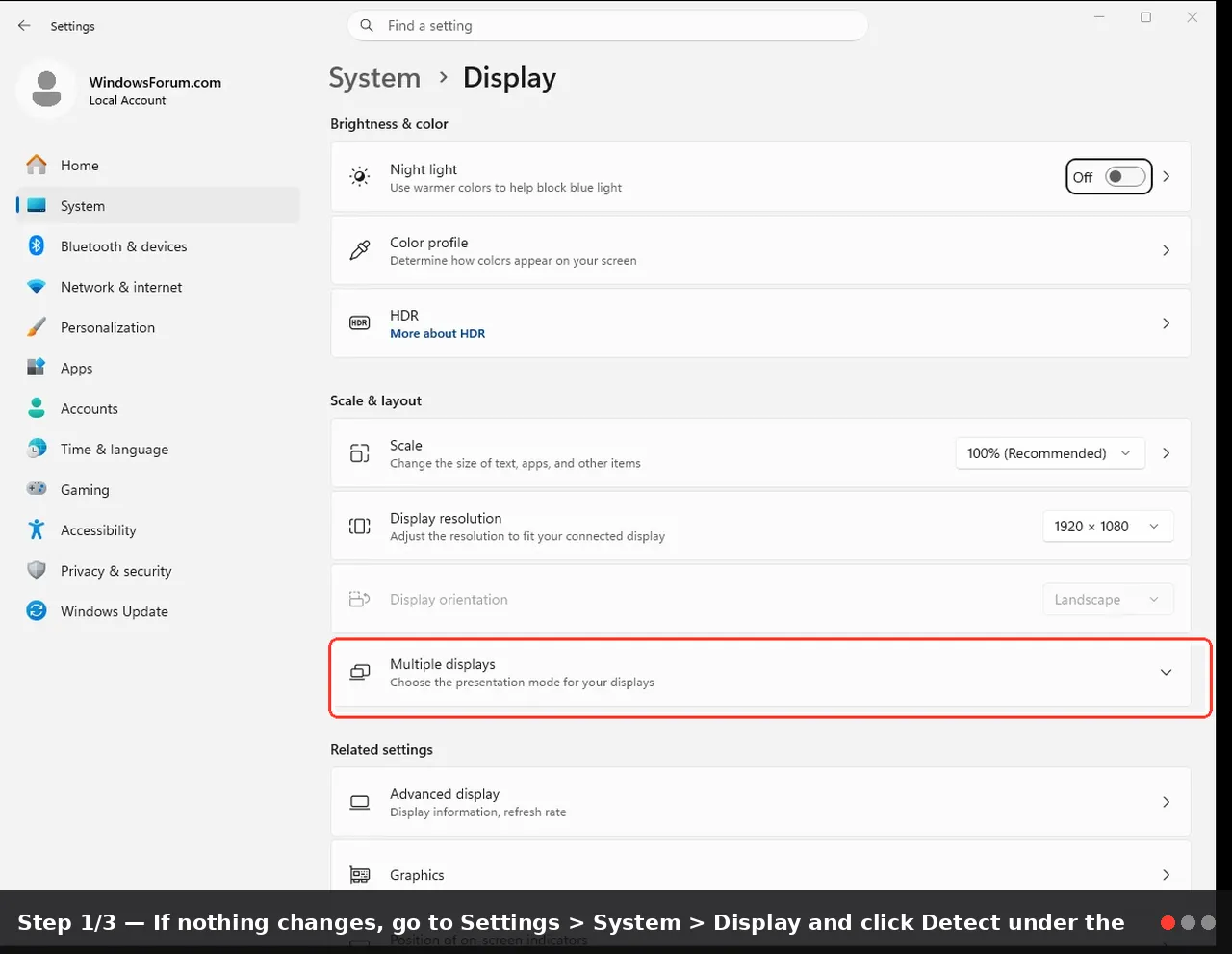

  1. Attempt display detection in Windows
  • Press Windows + P and choose Extend (or Duplicate) to force a display mode.
  • If nothing changes, go to Settings > System > Display and click Detect under the “Multiple displays” section.
  • Confirm you see the dock or any connected displays listed.
