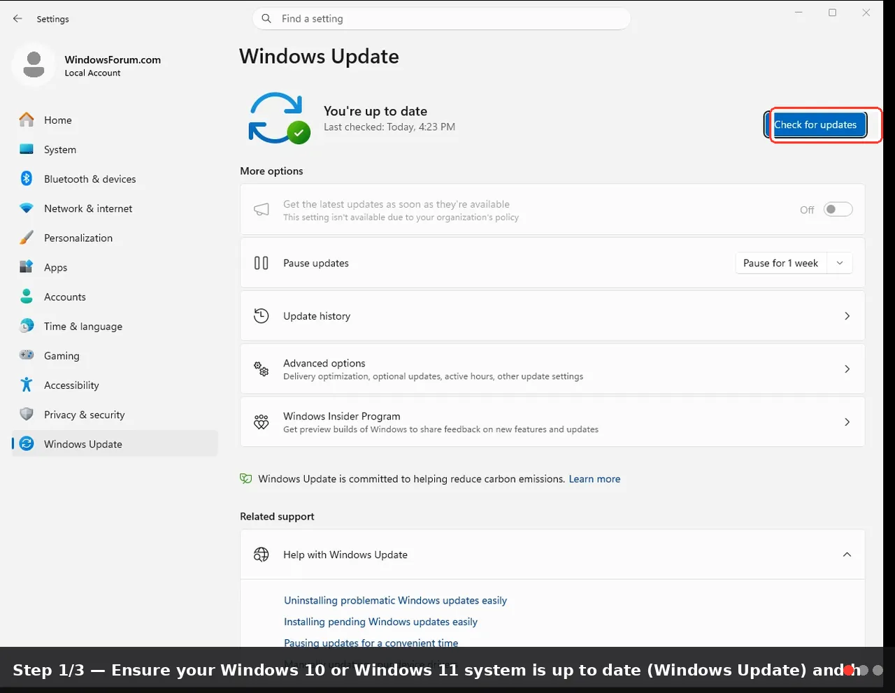

  • Ensure your Windows 10 or Windows 11 system is up to date (Windows Update) and has stable power, drivers, and internet access.

Windows Update page in Settings with the Check for updates button visible.
