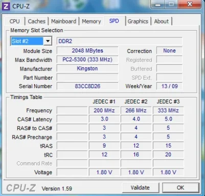

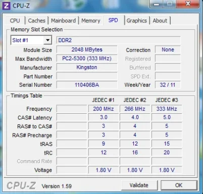

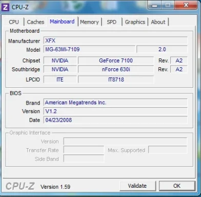

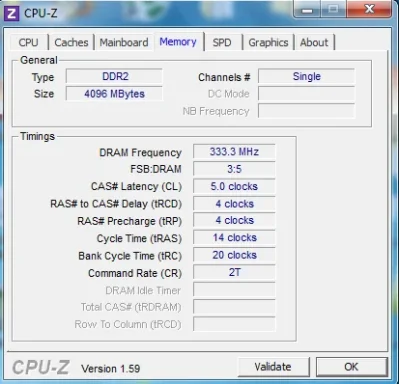

Download and run CPU-Z. Take screenshots**/snips of the Mainboard tab, Memory tab and all the slot #'s under the SPD tab.
Go to Post Reply, click on the Go Advanced button and attach the screenshots**/snips to your post for all the RAM experts to see by using the paper clip you will find on the top toolbar. Do not zip them up.

So I have done all the updates you have suggested, and I am waiting to see if the blue screen re-occurs. I am wondering why adding a stick of RAM causes all these problems with outdated drivers since it ran fine before the extra RAM was added.
Attached are the CPU-Z screenshots. As you can see, the RAM is perfectly matched other than the manufacturing date.
--Jeremy

You might want to check for an update to your 2008 bios. I can only give a link as far as the support page as you have to register to access their "tailored to your needs updates" (their words). Link Removed due to 404 Error
I think your ram timings might need a tweak as well. Currently set at 5-4-4-14 where I think it should be set to 5-5-5-15.
Yea I noticed the outdated BIOS, but that horrible support website won't let you get at the BIOS updates even after you register. They ask for the serial number which is, of course, on the bottom of the motherboard.
I will search for the box it came in, that might have the number. Until then, I will fix the RAM timings and hope for no more blue screens.
