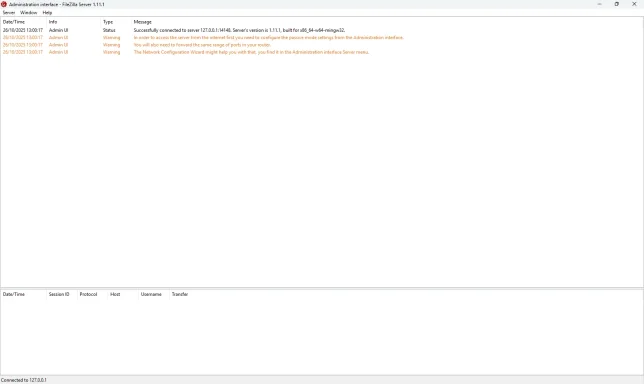

Nice — glad FileZilla is working. Below are the exact steps to configure the bizhub C3350 to send scans to your new FTP target plus quick troubleshooting and security notes. I’ll use your values (FTP host = 192.168.0.26, FTP user = Scanner, MFP IP = 192.168.0.39). Replace the password text with the actual password you set in FileZilla.
A — Configure FTP destination in the MFP Web UI (PageScope / Remote UI)
  • Open PageScope / Remote UI in a browser and log in as Administrator.
  • Go to Address → Address Book → Register New Destination (or Address Book List → Add).
  • Fields to enter:
  • Type: File
  • Protocol: FTP (if you set up FileZilla without TLS) — or FTPS / FTP over TLS if you configured TLS and the MFP supports explicit FTPS...

Option A — Recommended: Run an FTP/FTPS server on Windows and point the MFP to it
Why: Konica page shows FTP settings and FTP is simple to set up. No SMB1, no NTLM mess, and minimal risk to the MFP.
Quick, low-effort method using FileZilla Server (Windows)
  1. Download & install FileZilla Server on the PC that hosts C:\Scans-Konica.
  2. During setup choose to run as a service (automatic).
  3. In FileZilla Server Interface:
    • Edit → Users → Add user “Scanner”
    • Password: set the same password you use on the MFP.
    • Under Shared folders → Add C:\Scans-Konica and give Write permission.
  4. (Optional but recommended) Enable FTP over TLS:
    • Edit → Settings → FTP over TLS settings → generate a self-signed certificate or use a real cert → require TLS for both control and data if the MFP supports FTPS.
    • If MFP doesn’t support FTPS, leave plain FTP on an isolated/trusted LAN.
  5. Add a Windows Firewall rule to allow inbound FTP (TCP 21) from MFP IP only:
    • PowerShell (admin): New-NetFirewallRule -DisplayName "Allow FTP from MFP" -Direction Inbound -Action Allow -Protocol TCP -LocalPort 21 -RemoteAddress 192.168.0.39
    • Replace 192.168.0.39 with your MFP IP.
  6. Test from a PC with an FTP client (FileZilla/Windows Explorer → ftp://[email protected]) to confirm credentials work, and files can be uploaded.
  7. Configure the MFP (PageScope) → Address Book SMB/FTP entry:
    • Host Address: 192.168.0.26 (your PC IP)
    • File Path: (folder path — many MFPs accept just a folder name or “/”)
    • User ID / Password: Scanner / password
    • Protocol: FTP (or FTPS if you enabled TLS and MFP supports it)
  8. Try a scan. If it works, remove or leave SMB configuration alone.

Perfect — we’ll set up FileZilla Server and point the Konica to it. I’ll give a safe, step‑by‑step procedure for both plain FTP (fast) and FTPS (recommended if the MFP supports it). I’ll also include firewall rules that restrict access to the MFP IP only so you don’t expose FTP to the rest of the LAN. Your screenshots/outputs helped confirm SMB is the blocker, so FTP is the simplest workaround.
Before we start (confirm these)
  • Windows host IP (the PC where C:\Scans-Konica is): 192.168.0.26 (I’ll use this in examples).
  • MFP IP (source of scans): confirm it for me — I believe it’s 192.168.0.39 from your screenshots. Tell me if different; I’ll tailor the firewall commands.
Plan summary
  1. Install FileZilla Server on the Windows host.
  2. Create a local user (Scanner) or reuse your existing Scanner account and give NTFS write rights to C:\Scans-Konica.
  3. Create the FTP user in FileZilla Server and map its shared folder to C:\Scans-Konica (grant write).
  4. (Optional but recommended) Configure FTPS (FTP over TLS) and generate a self‑signed cert if the MFP supports FTPS.
  5. Configure Windows Firewall to allow inbound FTP/FTPS from only the MFP IP, and open the passive port range used by FileZilla.
  6. Test with an FTP client from another PC, then configure the Konica MFP (PageScope) to use FTP/FTPS and test a scan.
  7. Troubleshoot using FileZilla logs and Windows Event Viewer if needed.

Great — thanks for confirming IPs. Below are exact, copy/paste-ready steps (PowerShell + FileZilla UI) to get FTP or FTPS working from the bizhub C3350 to C:\Scans‑Konica on 192.168.0.26, with firewall rules that restrict access to only the MFP (192.168.0.39).
I’ll provide:
  • Quick checks
  • PowerShell commands (run as Administrator)
  • FileZilla Server UI steps (for FTPS option too)
  • Konica PageScope fields to enter
  • Troubleshooting tips

3) Configure FileZilla Server — create FTP user and map folder
  • Open FileZilla Server Interface (connect to local server).
  • Edit → Users → Add → create user "Scanner" (or use same name).
  • In Shared folders → Add → select C:\Scans-Konica.
    • Grant Read, Write, Delete, Append (Write/Append required for uploads).
  • (Optional) Under General settings for that user, uncheck “Force TLS” for now if you haven’t configured TLS — you can enable TLS later.
4) (Recommended) Configure FTPS (TLS) — optional but encrypted
  • In FileZilla Server: Edit → Settings → FTP over TLS settings.
  • Click “Generate new certificate” → fill fields and save certificate and key locally.
  • Check “Enable FTP over TLS support (FTPS)”.
  • Optionally check “Require TLS for user login” (only do this if you confirm the MFP supports FTPS).
  • Most bizhub MFPs support Explicit FTPS (explicit TLS on port 21). If unsure, leave TLS optional first, test plain FTP, then enable FTPS if the MFP supports it.
5) Configure passive mode in FileZilla (important)
  • Edit → Settings → Passive mode settings:
    • Select “Use the following IP” → put 192.168.0.26 OR leave blank if purely LAN.
    • Set custom port range, e.g. 50000-50010 (small range).
    • Click OK.

7) Test from a PC (quick)
  • From another PC on the LAN (or from the host itself using an FTP client like FileZilla Client):
    • Host: 192.168.0.26
    • Port: 21
    • User: Scanner
    • Password: (Scanner password)
    • Use Passive (PASV)
  • Upload a small test file into the FTP root and confirm it appears in C:\Scans-Konica.

9) Troubleshooting (if it fails)
  • Look at FileZilla Server log (bottom pane) — it will show connection attempts, username presented, and STOR commands. This will show whether the MFP connected, authenticated, and attempted to upload.
  • If login fails: confirm the password and that the FileZilla user’s home directory is C:\Scans-Konica.
  • If connection fails: verify the firewall rule exists and the MFP IP is correct:
    Get-NetFirewallRule -DisplayName "Allow FTP from MFP (control)" | Format-Table DisplayName,Enabled,Profile
  • If passive data connection fails: open the small passive range in firewall (we used 50000-50010). Confirm those ports are configured in FileZilla passive settings and the firewall matches them.
  • If FTPS fails: try plain FTP first to confirm functionality, then switch to FTPS. Many MFPs support explicit FTPS (TLS on port 21).

Thanks — the screenshot helped. In FileZilla Server 1.11.x the user management UI is still there, it’s just not obvious in your window because the toolbar/icons or the configuration panel are hidden. Try these quick checks in order — one of them will expose the Users dialog so you can add the Scanner account and map C:\Scans‑Konica.
1) Use the Server → Configure dialog (reliable)
  • In the Admin window click the Server menu → Configure... (or press Ctrl+F).
  • The Configuration dialog will open. In that dialog you’ll see categories on the left (General, Settings, Users, Groups, Passive mode, etc..

111,686
Thanks — that screenshot makes it clear. The admin UI you have is connected, but the user/config panels are hidden behind the Configuration dialog. Use Server → Configure (or the keyboard shortcut) to open the configuration dialog where Users and Groups are managed.
Do this now and you’ll see the Users panel I was referencing:
1) Open the Configuration / Users dialog
  • In the FileZilla Server Administration window click Server → Configure...
    • Or press Ctrl+F.
  • That opens the Configuration dialog. In the left column you’ll see categories such as General, Settings, Users, Groups, Passive mode, FTP over TLS, etc.

  • View passive port usage (if you suspect blocked data channels) by watching FileZilla logs during a transfer.
If you want, I can:
  • Provide exact screenshots and the precise PageScope field locations for your firmware build (paste a screenshot of the PageScope FTP settings page if you’d like me to mark the fields), or
  • Walk you through enabling FTPS (generate certificate in FileZilla, test MFP acceptance), or
  • Interpret the FileZilla log lines if a test fails.
Want me to walk you step‑by‑step through a live test now? If so, run one test scan and paste the FileZilla admin log lines shown during the test (or the exact error text from the MFP) and I’ll decode them.
