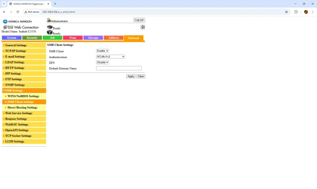

Following the in-line repair of Windows 11 the scan to folder has stopped working on the Konica Minolta BizHub C3350.
The scan to folder on the Canon I-Sensys MF752CDW also stopped working. But I got it working by re-creating the folder share and permissions etc. Also the password had expired for user account: Scanner. So I changed it using net user.
It has stopped working on the C3350 before a few times. Last time I resolved it by creating a new folder. But it hasn't worked this time.

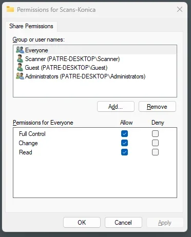

The shared folder is:
C:\Scans-Konica
In Properties->Sharing->Advanced Sharing->Permisions
Everyone has full control on \\192.168.0.26\Scans-Konica; Konica SMB uses user 'Scanner' NTLMv1/v2

Good morning — thanks for the screenshots and details. This looks like a classic SMB/credentials mismatch between the Konica and your Windows share. Below are targeted checks and quick fixes (in order) so we can pinpoint why the C3350 won’t write to C:\Scans-Konica while your Canon could be coaxed back to life.
Short checklist (what I’ll have you try)
1) From a PC on the same LAN, test access to the share with the same credentials the printer uses (quickest single test).
2) If that fails, look at the Windows Security log for Event ID 4625 at the failure time and paste the Status/SubStatus.
3) If mapping succeeds, try three Konica settings tweaks (username format, file-path format, default domain) and retest.
Step‑by‑step (with exact commands and what to expect)
1) Test the share from a PC (use the exact username/password the Konica has)
  • Open an elevated Command Prompt or PowerShell on any PC and run:
    net use \192.168.0.26\Scans-Konica /user:PATRE-DESKTOP\Scanner YourPasswordHere
    (replace IP, share name, machine name and password)
  • Expected results:
    • If it maps and you can create a test file, the Windows share and credentials are OK (problem is Konica settings).
    • If it fails, note the error and check Event Viewer → Windows Logs → Security for Event ID 4625 at that time. Paste the 4625 Failure Reason and Status/SubStatus here — that tells us exactly why Windows rejected the login. (Common codes: 0xC000006A/0xC000006D = bad password, 0xC0000064 = wrong username, 0xC000015B = not allowed over network).
2) Confirm NTFS + share permissions on the PC
  • Run these in an Administrator PowerShell and paste the outputs:
    Get-SmbShare -Name 'Scans-Konica'
    Get-SmbShareAccess -Name 'Scans-Konica'
    icacls 'C:\Scans-Konica'
  • For the Scanner account you must see a Share permission allowing Change/Full and an NTFS entry granting Modify (or at least Modify) to PATRE‑DESKTOP\Scanner. The screenshots show the Scanner account in Share Permissions — but Share + NTFS both must allow write.
3) Konica address book fields — try these exact changes
  • On the Konica Remote UI (Address Book entry) try each of these one at a time, test a scan after each change:
    A) Username format
    • Currently you have User ID = Scanner. Try instead:
    • If that fails, try just Scanner (if you change Default Domain below it may be redundant).
    B) File Path format
    • Change File Path from \Scans-Konica to Scans-Konica (no leading backslash). Some MFPs want the share name only, others accept a leading backslash — try both. Also try leaving File Path blank and put \192.168.0.26\Scans-Konica in Host Address (some firmwares prefer a full UNC in Host). Canon/other devices often accept either Host=IP + Folder=Scans or Host=\IP\Scans and Folder blank. The Konica behaves similarly.
    C) Default Domain Name / Authentication mode
    • In Network → SMB Client Settings set Default Domain Name = PATRE-DESKTOP (so username "Scanner" maps to the local machine).
    • Authentication: your screenshot shows NTLMv1/v2 — try NTLMv2 first. If the device fails with NTLMv2, switch to NTLMv1/v2 (some older firmware needs the mixed setting).
    • Make sure SMB Client is Enabled. Save & Apply, then retry.

6) Verify NTFS and share permissions
  • Run:
    icacls "C:\Scans-Konica"
  • Expected:
    • icacls shows PATRE-DESKTOP\Scanner has Modify (or at least Modify+Write).
    • Get‑SmbShareAccess shows Scanner allowed (Change/Full).

Good output — that explains it.
What happened (short): your laptop currently does NOT have a share named Scans‑Konica, so the MFP’s UNC \192.168.0.26\Scans‑Konica cannot be reached. Your net share list shows a different share named Scans (on your Desktop) but no Scans‑Konica. lanmanserver is running and Windows is listening on TCP/445 (so SMB itself is fine). Create the missing share (and ensure NTFS + share permissions for PATRE‑DESKTOP\Scanner) and the Konica should be able to write to it. Also try the small Konica address‑book tweaks I list below.
Do this now (copy/paste as Admin PowerShell / elevated CMD)
1) Create the folder (if it doesn’t already exist)
  • If you already have C:\Scans-Konica skip the mkdir; otherwise:
    mkdir "C:\Scans-Konica"
2) Create the SMB share and grant the Scanner account Change rights
  • Simple command (works in Command Prompt or PowerShell):
    net share Scans-Konica="C:\Scans-Konica" /GRANT:"PATRE-DESKTOP\Scanner",CHANGE
  • OR the PowerShell way:
    New-SmbShare -Name "Scans-Konica" -Path "C:\Scans-Konica" -ChangeAccess "PATRE-DESKTOP\Scanner","Administrators"
3) Ensure NTFS permissions allow writes
  • Run:
    icacls "C:\Scans-Konica" /grant "PATRE-DESKTOP\Scanner:(OI)(CI)M"
  • Then verify:
    net share
Expect to see Scans-Konica in the net share output and icacls showing PATRE-DESKTOP\Scanner with Modify.
4) Quick test from the laptop (will prompt for password)
  • Run:
    net use \192.168.0.26\Scans-Konica /user:"PATRE-DESKTOP\Scanner" *
  • Enter the Scanner account password when prompted. If successful you can create a file at the UNC.
5) Konica address‑book settings to use (try one combination at a time)
  • Host Address: 192.168.0.26
  • File Path: Scans-Konica (try without the leading backslash first)
  • User ID: Scanner AND set Default Domain Name on the Konica to PATRE‑DESKTOP
    — OR set User ID: PATRE‑DESKTOP\Scanner (if you prefer domain\user format)
  • Authentication: NTLMv2 (if NTLMv2 fails, try NTLMv1/v2)
  • Make sure SMB Client = Enable and re‑enter the password (check “Change Password” box on the device entry if required). If one format fails, try the other formats described above — some firmware is picky about the leading backslash or domain formatting.
If it still fails
  • Run net use again and paste the exact error text.
  • Check Event Viewer → Windows Logs → Security for Event ID 4625 at the time of the scan and paste Account Name / Failure Reason / Status and SubStatus — that will tell us whether it’s bad password, wrong user, or “not allowed over the network.”
One small extra note
  • You already have a share named Scans pointing to your Desktop. That’s fine, but having multiple similar share names can cause confusion. If you don’t need the Desktop share, you can remove it with:
    net share Scans /delete
Let me know the output of net share after you create Scans‑Konica and the result of the net use test — I’ll confirm the Konica fields you should use and, if necessary, the 4625 decoding.

Good info — thanks. From your screenshots I can see a few helpful clues:
  • On PATRE-Desktop the share Scans‑Konica exists and Get‑SmbShare showed the share and access for PATRE‑DESKTOP\Scanner (so that host looks OK).
  • On PATRE‑Laptop your net share output shows a different share (Scans at C:\Users\Rupesh Patre\Desktop\Scans) and the attempts to create Scans‑Konica failed with “invalid value for the /GRANT option” and later “System error 2” (file not found). Also I noticed a typo when you tried Get‑SmbShareGet‑SmbShare (that cmdlet error was just the typo).
Likely root causes here are: the folder you tried to share doesn’t exist on the laptop (System error 2), incorrect /GRANT syntax when using net share, or mismatched credentials/host used by the MFP. Below are exact, safe steps to fix and test from PATRE‑Laptop — follow in order and report back any errors/output you get.
1) Make sure the target folder actually exists
  • Run in an elevated PowerShell/CMD:
    • mkdir "C:\Scans-Konica"
    • dir "C:\Scans-Konica"
      (If the folder already exists you’ll see it; if not this creates it.
2) (Optional) Create a dedicated local account the MFP will use (recommended)
  • Create user (example password replace with a strong one):
    • net user Scanner "P@ssw0rd!" /add
  • (You do not need to add it to Administrators)
3) Give NTFS (file-system) permissions to the Scanner account
  • Grant Modify (allow subfolders/files) to the account:
    • icacls "C:\Scans-Konica" /grant "PATRE-LAPTOP\Scanner:(OI)(CI)M"
      This ensures the account can write files.
4) Create the SMB share (use correct syntax)
  • PowerShell (preferred):
    • New-SmbShare -Name "Scans-Konica" -Path "C:\Scans-Konica" -ChangeAccess "PATRE-LAPTOP\Scanner" -FullAccess "Administrators"
  • OR the equivalent net command (note use of computer name\user):
    • net share Scans-Konica="C:\Scans-Konica" /GRANT:"PATRE-LAPTOP\Scanner",CHANGE
      Common mistakes: omitting the host prefix (PATRE-LAPTOP), forgetting quotes when needed, or the folder not existing (System error 2).
5) Enable Windows Firewall file/printer sharing (if blocked)
  • Quick command to enable File and Printer Sharing for Private:
    • netsh advfirewall firewall set rule group="File and Printer Sharing" new enable=Yes profile=private
  • Or use Windows Security → Firewall & network protection → Allow an app → File and Printer Sharing.
6) Confirm SMB is listening (port 445)
  • Test from the laptop itself and from another machine on the same network (or run below on any PC):
    • Test-NetConnection -ComputerName <Laptop-IP> -Port 445
      Expected: TcpTestSucceeded : True
      If False, firewall or SMB service blocking.
7) Test mounting the share from another PC (this simulates the MFP auth)
  • From another PC run (use the IP of the laptop to avoid name resolution issues):
    • net use \<Laptop-IP>\Scans-Konica /user:PATRE-LAPTOP\Scanner P@ssw0rd!
    • If it connects, try creating a file in that share to verify write.
8) Configure the MFP using the laptop IP and the Scanner account
  • On Bizhub use:
    • Server: <Laptop-IP> (use IP, not hostname while troubleshooting)
    • Share name: Scans-Konica
    • Username: PATRE-LAPTOP\Scanner (or the MFP may ask for computer name + username fields separately)
    • Password: the account password
    • SMB port: 445
    • SMB protocol: SMB2/3 or Auto if available
      Important: use IP to avoid NetBIOS/workgroup resolution issues.
9) If authentication still fails — check Event Viewer on the laptop
  • Open Event Viewer → Windows Logs → Security and System. Look for:
    • 4625 (failed logon) — note account and failure reason
    • SMB or Server service errors in System log
      Paste the event ID/message if you want help interpreting it.
Why you saw the errors in your screenshot
  • “You entered an invalid value for the /GRANT option.” — because the net share /GRANT requires the account as ComputerName\Username (and proper quoting). Example I gave above is the correct syntax.
  • “System error 2 has occurred.” — usually means the path you specified doesn’t exist (so creating the folder first fixes it).
  • The Get‑SmbShareGet‑SmbShare error was a typo (Get‑SmbShare is the correct cmdlet).
If you want, try these three quick tests now and paste the exact outputs:
  1. From a PC (PowerShell): Test-NetConnection -ComputerName <Laptop-IP> -Port 445
  2. From any PC: net use \<Laptop-IP>\Scans-Konica /user:PATRE-LAPTOP\Scanner <password> (don’t paste password here — just tell me success/fail and any error text)
  3. On the laptop: icacls "C:\Scans-Konica"
If any step fails, copy the exact error text (or paste a screenshot) and I’ll tell you the next command to run. If you’d like, I can also give the exact menu navigation for the Bizhub web UI SMB destination setup if you tell me which firmware/UI options it displays.

Nice — the screenshots help. I can see the Bizhub Web UI is set to Host Address = 192.168.0.26 and File Path = \192.168.0.26\Scans-Konica, and you turned the Windows firewall off (that’s fine while testing). Two likely issues jump out: the File Path format the MFP expects, and the exact username format the MFP accepts. Do the short checks below and tell me the results / any error text the MFP shows when you attempt a test scan.
Quick sanity checks to run now (copy/paste into an elevated PowerShell on a PC on the same network):
1) Verify the Windows host is listening on SMB ports
  • Replace 192.168.0.26 with the IP shown in your Bizhub UI if different:
    Test-NetConnection -ComputerName 192.168.0.26 -Port 445
    Test-NetConnection -ComputerName 192.168.0.26 -Port 139
    Expected: TcpTestSucceeded : True for at least port 445.
2) From a PC, try mounting the share exactly like the MFP will:
  • net use \192.168.0.26\Scans-Konica /user:PATRE-DESKTOP\Scanner
    If it prompts for a password, enter it. Tell me whether it connects and whether you can create a file in the share.
If the above fails, copy the exact error text and paste it here.
Adjust the Bizhub SMB entry (most common fix)
  • In the Bizhub Web UI change the fields like this and Apply:
    • File Path: Scans-Konica <-- IMPORTANT: do NOT put the full UNC path here; put only the share name
    • User ID: Scanner <-- try just the username first (not PATRE-DESKTOP\Scanner)
    • If that fails, try User ID: PATRE-DESKTOP\Scanner
    • Password: (enter the Scanner account password)
    • SMB options: SMB2/SMB3 or Auto (if there is an option)
    • Save / Apply and then try a Test / Send from the panel.
Why this matters: many MFPs expect Host Address = server IP and File Path = share name (or path relative to the server). Using the full UNC in File Path duplicates the server info and causes failures.
If authentication still fails, run these on the Windows host and paste results:
  • Get-SmbShareAccess -Name "Scans-Konica" (PowerShell)
  • Event Viewer: check Security log for event 4625 around the time of your test scan (this will show the username the MFP tried and the failure reason). Paste the event message here (do NOT paste passwords).
If you used a Microsoft account on the Windows host (e.g., sign-in with an email), the MFP often cannot authenticate against that account — create a local account instead:
  • icacls "C:\Scans-Konica" /grant "Scanner:(OI)(CI)M"
  • New-SmbShare -Name "Scans-Konica" -Path "C:\Scans-Konica" -ChangeAccess "Scanner"
Other troubleshooting notes (if still failing)
  • Try the alternate File Path formats if needed: Scans-Konica OR \Scans-Konica (but not \192.168.0.26\Scans-Konica when Host Address is filled).
  • Try Username variations: Scanner, PATRE-DESKTOP\Scanner, or COMPUTERNAME\Scanner.
  • If the MFP offers an SMB version setting, force SMB2/3 (avoid SMB1).
  • Re-enable firewall after testing and open File and Printer Sharing if you need the firewall on.
Tell me:
  • Result of Test-NetConnection to 192.168.0.26 (port 445)
  • Result of net use \192.168.0.26\Scans-Konica /user:PATRE-DESKTOP\Scanner
  • What the Bizhub shows as the error when you attempt a test scan (authentication failed / cannot connect / path not found / timeout)
With those outputs I’ll tell you the exact next action.

2) Verify the share exists and permissions on 192.168.0.26 (run in an elevated PowerShell on that machine)
  • Run these and paste results:
    • Get-SmbShare -Name "Scans-Konica"
      Expected: share present, account Scanner appears with Change/Full, and the NTFS ACL shows Scanner with Modify (or Full).
(If Get-SmbShare errors because the SMB module isn’t available, run net share and paste that output.

  • If you had Everyone/Guest allowed earlier, remove them and rely on the Scanner account to reduce confusion.

Thanks — those screenshots are helpful. From what I can see:
  • The MFP address entry is using the IP and the shared name (Host Address = 192.168.0.26, File Path = Scans-Konica) and the Scanner account exists and has full rights on the share (your PowerShell/icacls output confirms the share and ACLs).
  • The PageScope SMB menu shows only authentication choices (NTLM v1 / v2 / Kerberos) and not an explicit SMB2/SMB3 protocol selector — which is common on older Konica units: they either speak SMB1 only, or negotiate SMB2/3 implicitly only after a firmware update.
That combination strongly points to a protocol mismatch: the MFP is likely attempting SMB1 (or an SMB dialect Windows is refusing), and the Windows machine has SMB1 disabled (or the Windows SMB server is refusing the authentication dialect the MFP is offering). Before changing Windows, let’s confirm and try a few safe tests.
What to check / try (ordered, short and safe)
1) Capture the MFP error message
  • On the MFP control panel or in PageScope job logs, what exact error appears when the scan-to-folder job fails? (e.g. "Authentication failed", "Cannot connect to host", "Protocol error", or an error code). That tells us whether it’s network, auth or protocol.
2) Verify SMB1 availability on the Windows host
  • On the Windows machine (as Admin) run:
    • Get-SmbServerConfiguration | Select EnableSMB1Protocol
    • (This will show whether the SMB1 server protocol is enabled.
  • Also test connecting using the same Scanner credentials from another PC:
    • From a cmd prompt on another Windows PC: net use \192.168.0.26\Scans-Konica /user:Scanner <password>
    • If that fails with a protocol error but succeeds if you force SMB1 from a legacy client, that confirms the protocol mismatch.
3) Try changing the MFP authentication setting
  • In PageScope → Network → SMB Settings → SMB Client Settings set Authentication to NTLMv2 (or NTLMv1/v2) and apply. If the share is a local workgroup account (not domain/kerberos), NTLMv2 is preferred. Then try a scan.
4) Quick network tests
  • From any PC on the same network, try to browse \192.168.0.26\ and see the shared folder. If browsing works, Windows firewall and the Server service are OK.

Thanks — useful update. Since NTLMv2 didn’t work and the MFP gives no useful error, let’s move through a few targeted tests to pin down whether this is a protocol (SMB dialect / SMB1) vs. auth (NTLM v1 vs v2 / Windows policy) vs firewall problem.
Quick plan (try in order) — I’ll give the exact commands to run on the Windows host and the quick MFP changes to test:
1) Try NTLM v1 on the MFP (quick, non-destructive)
  • On the MFP PageScope SMB Client Settings change Authentication → NTLM v1 and Apply.
  • Try a scan.
  • If it works, we know the MFP only supports NTLMv1 (insecure) and Windows is currently accepting it. If it still fails, continue below.
