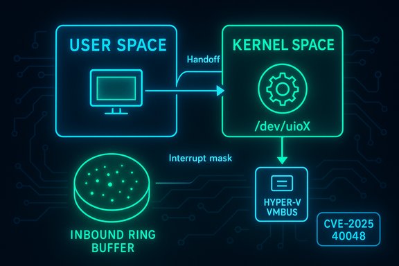

Neon diagram of user-space to kernel-space handoff over Hyper-V VMBUS with an inbound ring buffer.Background / Overview​

Technical anatomy: what the bug is and how it manifests​
The components involved​
  • uio_hv_generic: the kernel driver that exposes Hyper‑V VMBus channels to userspace via /dev/uioX.
  • Inbound ring buffer: the structure where host messages are queued for the guest.
  • Interrupt mask bit: a flag that controls whether the host should generate interrupts for inbound-to-empty→not-empty transitions.
  • Userspace daemon (e.g., hv_fcopy_uio_daemon): the process that reads the ring buffer, clears entries, and re‑arms the interrupt mask via the standard userspace API.
The race in plain language​
  • The host writes a message into the inbound ring buffer. If the mask is clear and the buffer transitions from empty to non‑empty, the host must generate an interrupt to wake the guest readers.
  • The kernel driver, as shipped in some trees, could set the inbound interrupt mask to 1 (masked) by default in certain code paths.
  • If the host places a message while the kernel has masked interrupts, it will not signal the guest — the message sits in the ring.
  • Later, userspace sets the interrupt mask to 0 (unmasked) and calls pread expecting either an interrupt or to discover an existing message. But because the kernel's relative ordering allowed the driver to mask at the wrong time, userspace can block waiting for an interrupt that will not arrive — the host will not retrigger an interrupt for the existing pending message because the ring never transitioned from empty to non‑empty in the userspace-visible chronology.
  • The result: the userspace process can hang waiting forever.
