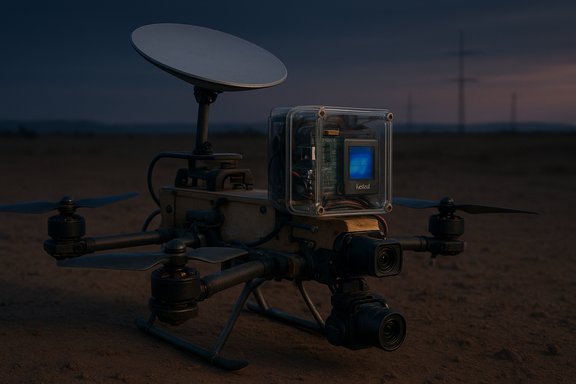

Quadcopter drone with satellite dish and exposed camera rig on a desert at dusk.Background​

What the diagram and reporting actually say​
  • The Molniya‑2R keeps the forward‑facing FPV camera used for basic navigation and adds a dedicated electro‑optical pod — the SIYI ZR10 — with a three‑axis gimbal and 10× optical zoom, intended for precise observation and target confirmation.
  • The system reportedly combines two computational elements: a low‑power embedded controller such as a Raspberry Pi 5 for sensor fusion or flight‑adjunct tasks, and a more capable x86 mini‑PC (reported as Mini PC F8 / brand Raskat) to handle video encoding, satellite link management and higher‑level software — the latter allegedly running a licensed copy of Windows 11.
  • A Starlink terminal is shown as the primary beyond‑line‑of‑sight communications channel, relaying real‑time video from both cameras, telemetry and, reportedly, control commands. Previous open‑source reporting and recovered imagery have documented consumer satellite terminals attached to Molniya‑type drones in 2024–2025, making the architecture plausible.
