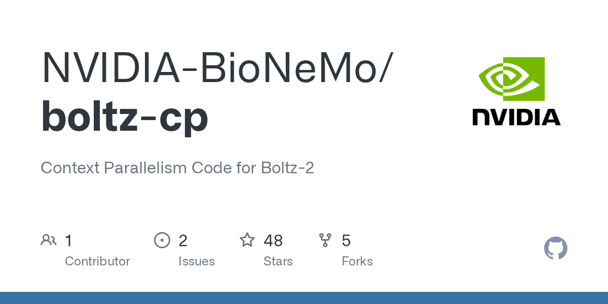

The official Boltz-CP repository describes the implementation as a proof of concept and says the context-parallel capability is being worked toward the upstream Boltz codebase. That caveat should shape adoption: Fold-CP is evidence that the memory wall can be moved, but it should not yet be treated as an invisible switch in an established production scheduler.
