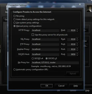

#14
Download and install the TOR package. Make sure Vidalia is running in the system tray and green. It looks like an onion.
Then open Firefox. Go to Tools | Options | Advanced | Network | Settings
Make it look like my screen shot then save.
Then try your site.
