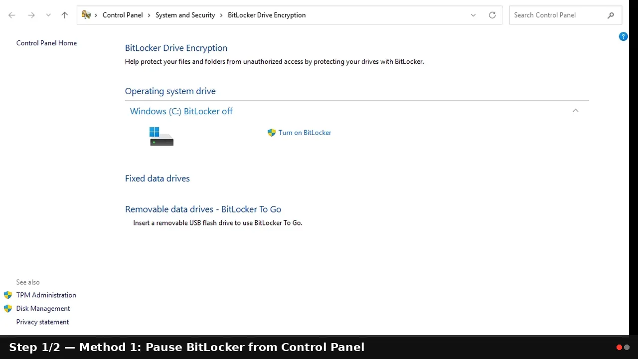

Method 1: Pause BitLocker from Control Panel​
Control Panel on the BitLocker Drive Encryption page with the operating system drive and suspend option.
This is the easiest method for most forum users.
  • Press Start, type Control Panel, and open it.
  • Go to System and Security > BitLocker Drive Encryption.
  • Find your operating system drive (usually C:).
  • Click Suspend protection.
  • When prompted, click Yes to confirm.
BitLocker is now suspended, which means the drive remains encrypted, but Windows temporarily stores the unlock information so firmware changes won’t immediately trigger recovery.
  • Run your BIOS, UEFI, or firmware update as instructed by the manufacturer.
  • Restart the PC if required.
  • Return to Control Panel > BitLocker Drive Encryption.
  • If BitLocker hasn’t resumed automatically, click Resume protection.
Note: Suspending BitLocker is not the same as turning it off. Turning it off decrypts the drive completely and can take a long time.
