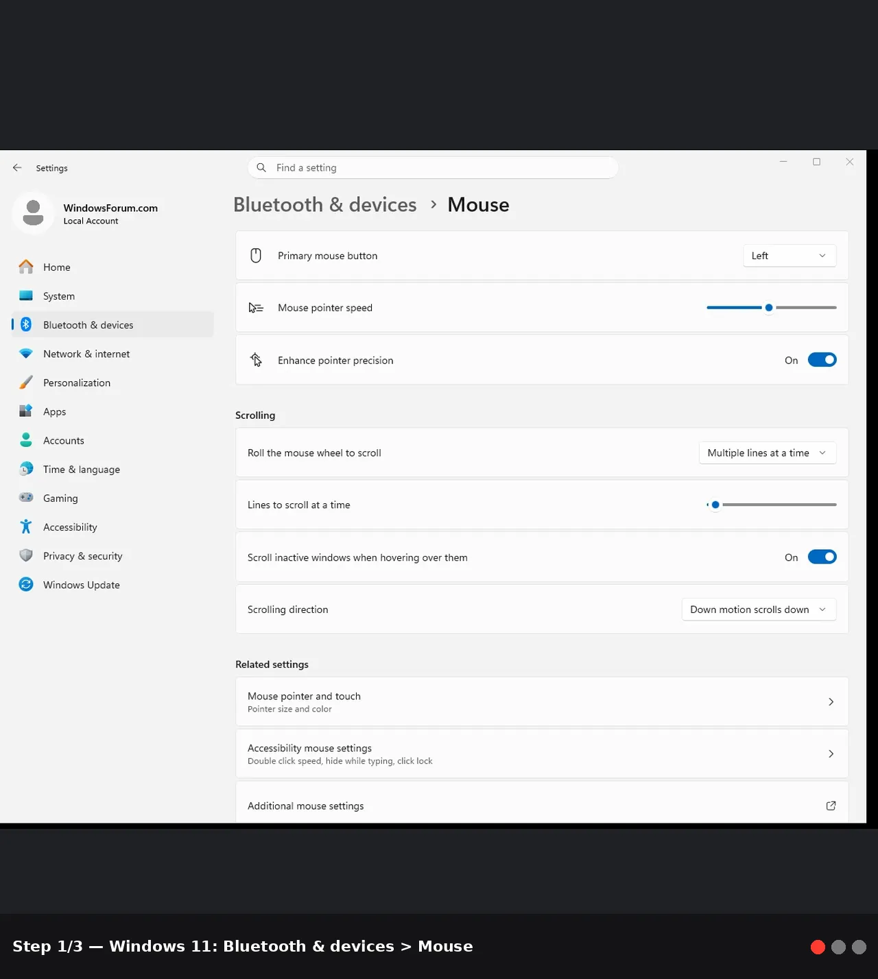

1. Open Mouse Settings​
On Windows 10 or Windows 11, press Windows + I to open Settings.
Then go to:
  • Windows 11: Bluetooth & devices > Mouse
  • Windows 10: Devices > Mouse
Windows 11 Mouse settings page with pointer speed and additional mouse settings link.
This is the main mouse settings area, but the acceleration option is usually located in the older Control Panel settings.
