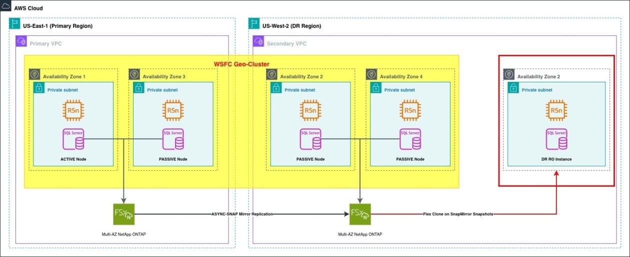

The AWS write-up says the business requirement was specific: once the decision to fail over had been made, the disaster recovery read-only system had to become operational and accessible within 15 minutes. That is a useful number because it forces the architecture away from vague resilience language and toward operational mechanics. The system either presents usable data in the secondary region inside that window, or it does not.
The trick is that S&P Global did not try to make every part of the platform instantly read-write in the disaster region. Instead, it accepted a more nuanced model: get customers back to essential information quickly in read-only mode, then execute the heavier process required to resume full read-write operations. That is not a compromise disguised as innovation. It is an acknowledgment that not every recovery objective carries the same urgency.
That matters because disaster recovery runbooks often fail at the seams between infrastructure readiness and application cutover. Storage might be replicated, compute might exist, and networks might be routable, but the actual recovery clock keeps running while teams connect those pieces under stress. S&P Global’s design reduces the first failover action to something closer to redirection than reconstruction.
FlexClone is doing important work here. In NetApp ONTAP terms, a FlexClone volume can be created from a snapshot while sharing unchanged data blocks with its parent. That makes it fast and space-efficient compared with building a full independent copy. In S&P Global’s case, AWS says FlexClone creation completes in under two minutes, which leaves most of the 15-minute window for validation and traffic cutover rather than storage provisioning.
There is also a subtle operational benefit: the clone is independent of the active SnapMirror relationship. That means the disaster recovery read-only instance can serve traffic without interrupting ongoing replication from the production environment. The clone represents a consistent point in time; the replication relationship continues doing its job.

SQL Server disaster recovery is full of sharp edges because the database is rarely the only thing that matters. Storage consistency, cluster behavior, application connection strings, identity, DNS, network paths, and release processes all become part of the recovery story. The AWS post describes a compute layer spanning regions, storage on two FSx for ONTAP file systems, SnapMirror replication from US-East-1 to US-West-2 at 15-minute intervals, and FlexClone volumes for rapid recovery.
That combination signals a hybrid of familiar Windows enterprise patterns and cloud-native service consumption. The cluster and SQL Server topology still require the kind of discipline Windows administrators already know. But the storage layer shifts from self-managed ONTAP infrastructure to Amazon FSx for NetApp ONTAP, which preserves ONTAP features while moving the operational burden into a managed service.

AWS’s own FSx for ONTAP documentation distinguishes between high availability within a region and disaster recovery across regions. Multi-AZ file systems can provide resilience across Availability Zones in a region, while SnapMirror can replicate data to another ONTAP file system, including one in another AWS Region. S&P Global’s case uses both the language and the mechanics of regional separation because the business requirement is not merely surviving an instance or AZ failure.
That distinction matters because cloud marketing often collapses resilience into a single word. High availability is not disaster recovery. Backups are not replication. Snapshots are not a runbook. A second region is not a service until applications, users, networks, and operating procedures can actually use it.
S&P Global’s design is notable because it does not pretend that one mechanism solves everything. SnapMirror handles replicated data protection. FlexClone handles rapid presentation of a consistent copy. The Windows Server Failover Cluster and SQL Server topology provide the compute and database framework. The application cutover process turns those parts into a customer-facing recovery state.
