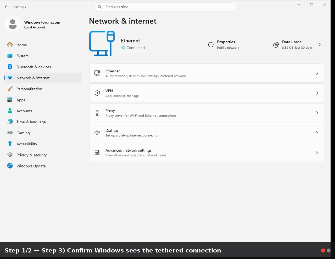

Step 3) Confirm Windows sees the tethered connection​
Windows 11 Network & internet status page showing the active connection status.
  • On Windows, open Settings:
  • Windows 11: Settings → Network & internet
  • Windows 10: Settings → Network & Internet
  • Look for a new connection such as:
  • Ethernet (often shows as “Remote NDIS based Internet Sharing Device” on Android)
  • Apple Mobile Device Ethernet (common for iPhone)
  • Verify the PC has internet:
  • Open a browser and load a site, or
  • Open Command Prompt and run:
    ping 1.1.1.1
Note: USB tethering typically appears as an “Ethernet” connection even though it’s coming from a phone.
