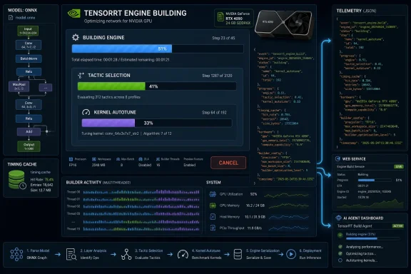

The TensorRT progress-monitor API is intentionally small. In both Python and C++, an implementation responds to three lifecycle events:| Event | Python | C++ | Purpose |
| A phase starts | phase_start(...) | phaseStart(...) | Register the phase and its total number of steps |
| A step completes | step_complete(...) | stepComplete(...) | Update progress and decide whether the build continues |
| A phase ends | phase_finish(...) | phaseFinish(...) | Remove or finalize the phase |
That hierarchy enables useful output such as:
Code:
Building Engine [██████████················] 9/24
Tactic Selection [████████████████··········] 41/64
Kernel Autotune [████████··················] 8/25
The callback that controls cancellation
Only one callback returns a value:step_complete(phase_name, step) -> boolbool stepComplete(char const* phaseName, int32_t step) noexceptReturning
True or true tells TensorRT to continue. Returning False or false asks TensorRT to stop the build cleanly.That distinction is central to a correct design:
phase_startis informational.phase_finishis informational.step_completeis both informational and actionable.

_publish() method is deliberate. It is the application boundary. A terminal tool can render ANSI progress rows there; a web service can enqueue JSON events; an IDE extension can send a protocol notification; and an agent workflow can emit a structured status chunk.This separation is more robust than placing terminal-specific rendering logic directly into the callback implementation.

Cancellation: Clean, Cooperative, and Not Instantaneous
The most valuable feature ofIProgressMonitor is that it gives the application a supported cancellation route. But it must be understood as cooperative cancellation, not a hard kill switch.When a user presses Ctrl+C, clicks Stop in an IDE, cancels an HTTP request, or exceeds an agent time budget, the application marks the monitor as cancelled. The next call to
step_complete() returns False, and TensorRT begins unwinding the build.The cancellation path looks like this:
- The outer application receives a stop request.
- It records the cancellation request in monitor state.
- TensorRT completes its active optimizer step.
- TensorRT calls
step_complete(). - The monitor returns
False. - TensorRT stops issuing further work and finishes active phases early.
- The build call returns without a serialized engine.

Where to Surface TensorRT Build Events
The strongest architectural advantage ofIProgressMonitor is that it decouples TensorRT build internals from application presentation.Terminal tools
For local Python scripts or C++ command-line utilities, render nested progress bars when an interactive terminal is detected. Fall back to line-oriented status updates or JSON logs when output is redirected.IDE integrations
An IDE extension can map each TensorRT phase into its own progress notification. The parent-child relationship can become nested UI progress, whilestep_complete() produces incremental reports.A Stop button should call the same application-level cancellation method used by Ctrl+C. This keeps the cancellation semantics consistent regardless of how the user initiated the request.
HTTP services
A build service can run TensorRT in a dedicated worker thread or worker process while publishing events through Server-Sent Events, WebSockets, or a job-status endpoint.A practical API design includes:
POST /buildsto begin a buildGET /builds/{id}for current statusGET /builds/{id}/eventsfor progress streamingPOST /builds/{id}/cancelto request cooperative cancellation
running to cancelling before a final cancelled state. That reflects the real behavior of TensorRT’s step-boundary cancellation model.AI agents and automation systems
Agent runtimes benefit from structured build events because they can report intermediate status, enforce budgets, and choose whether to wait or cancel.Instead of allowing an agent tool call to go silent for several minutes, emit compact status chunks:
Code:
"kind": "progress",
"operation": "tensorrt_engine_build",
"phase": "Tactic Selection",
"step": 47,
"total": 64
The Operational Payoff
