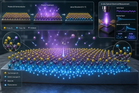

Tohoku’s contribution is to put a plausible mechanism under that observation. The team built an in-situ optical-electrical measurement system that could track structural and electrical changes during plasma treatment. Instead of treating the plasma as a blunt chemical hammer, the researchers watched the electrical state of the material evolve while the reaction unfolded.
Their answer is that electrons from the plasma accumulate near the 2D material and at the interface with the substrate. Those excess electrons weaken metal-chalcogen bonds and lower the energy barrier for substitution. Ultraviolet illumination, which increased electron accumulation, accelerated the reaction by more than a factor of two, giving the mechanism an experimental lever rather than merely a post-hoc explanation.

In this case, the researchers identify electron accumulation not only near the TMD surface but also at the material-substrate interface. That detail matters because it suggests the substrate is not merely holding the sheet in place. It is participating in the reaction environment by helping define where charge resides and how bonds respond.
This is where the science becomes both encouraging and inconvenient. If the interface can help drive selective substitution, then better interfaces may enable better Janus materials. But the reverse is also true: changing the substrate, dielectric, surface preparation, illumination, or plasma conditions could alter the reaction in ways that frustrate reproducibility.
The earlier mystery around Janus formation came from the mismatch between the gentleness of the desired outcome and the violence usually associated with breaking and remaking bonds. Selectively replacing only the outermost chalcogen atoms while preserving the underlying lattice is a very specific operation. It is more like changing the roof tiles on a house than demolishing and rebuilding the structure.
The electron accumulation model makes that selectivity more believable. If excess electrons weaken particular bonds and assist hydrogen-mediated substitution, then the reaction does not require brute-force thermal activation across the entire crystal. It can proceed where the charge and chemistry create a favorable pathway.

The ultraviolet-light experiment is particularly useful because it gives the model a perturbation test. If increasing electron accumulation accelerates the reaction, the mechanism gains predictive power. It is no longer just an elegant explanation for data already collected; it begins to behave like a design rule.
That knob is accumulated charge. If electron density at the surface and interface helps determine substitution kinetics, then process recipes can be built around measurable electrical states rather than only exposure time or plasma power. That is a more sophisticated way to think about plasma-assisted chemistry.
