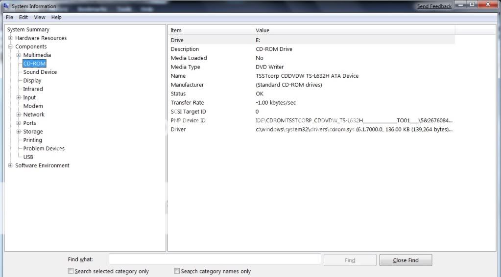

TSSTcorpCDDVDW TS-L632H ATA Device not work ....
how shold i do.
pls help me.

In order to troubleshoot your problem we need to know more detailed specs of your system hardware.
1. Go to Start > Run, and type msinfo32, look under the Components section for hardware identification
2. Go to Control Panel > Device Manager and look for any entry that has a yellow flag beside it
3. The manufacturer name and model number of your PC, if applicable
4 Please fill out your computers specs in the User Control Panel here on the site as well. It will then appear next to your name. look at my posting and you'll see the drop-down arrow.

msinfo32
Link Removed - Invalid URL

You may have to open the case and change the jumpers on the DVD Rom. If it's set to Cable select, set it to Master or Slave. If it's set as Slave, set it to Master. If it's set as Master, set it to Slave.
