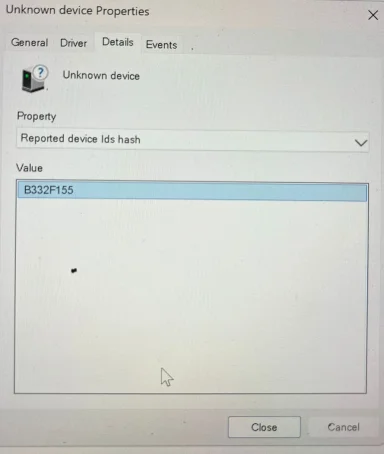

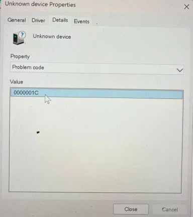

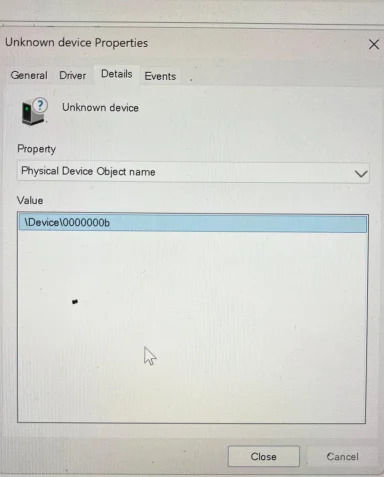

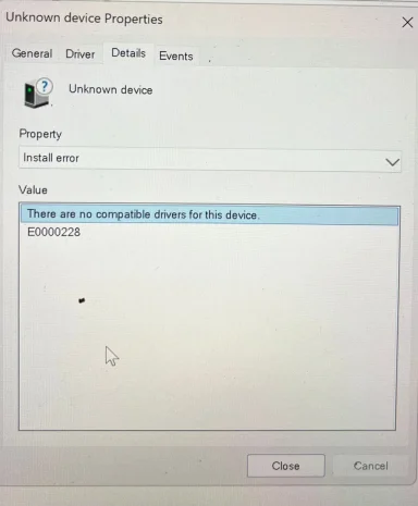

HI
Thank you so much for your time and effort. I really appreciate the help so much. I did all the steps above but unfortunately no luck and got UNKNOWN DEVICE back after win repair , sorry for that . Couldn't find a log from SURFACE DIAGNOSTIC TOOL but Here is the info of computer and DEVICE ( photos):
COMPUTER:
COMPUTER:

Thanks — this is very helpful. The screenshots and the Surface Book 2 model (1832) confirm we’re dealing with the Windows Hello face/IR firmware/driver interface being present but the kernel/driver package for the Hello IR/liveness stack isn’t installed (Device shows Root\WindowsHelloFaceSoftwareDriver / reported ID hash B332F155 and Problem code 0x1C / install error E0000228). That matches the common symptom where the regular camera works for video but the IR/liveness portion (Hello) is missing or blocked. a focused troubleshooting plan you can do now, ordered from least‑to‑most invasive. After each step, tell me the exact output (or paste screenshots) and I’ll tell you the next move.
What to try next (step‑by‑step)
1) Confirm the Hello-related PnP devices and collect IDs (quick, low risk)
2) Check whether Windows can enumerate the driver store (pnputil) and list installed driver packages
3) Re‑install the o drivers + firmware (the correct package)
4) Check the new Windows 11 “additional spresent)
5) If pnputil showed driver enumeration errors or DriverStore eset ACLs and recheck
6) If nothing above works — capture diagnostic output (Surface Diagnostic Toolkit /ce Diagnostic Toolkit for Business (or the Surface Diagnostic) and save the logs. If you can’t find it, tell me and I’ll post exact filenames to look for. Those logs can show a failed INF installation or firmware flash error. If you have the toolkit output, paste the ID or log excerpts here and I’ll read them.
7) Hardware possibility and last resorts
- Open an elevated PowerShell (right‑click Start → Windows Terminal (Admin) and run:
- Get-PnpDevice -PresentOnly | Where-Object InstanceId -Match 'HELLO|FACE'
- Get-PnpDevice -InstanceId "Root\WindowsHelloFaceSoftwareDriver" (replace the InstanceId if your Device Manager shows a slightly different string)
- Copy/paste the full text output here (or attach a screenshot). That confirms how Windows enumerates the device and gives the full InstanceId we need to find a matching driver package. If PowerShell returns nothing, run:

Thanks — the output is very useful. Good news: Device Manager / your PowerShell run shows the camera pieces are present (Intel(R) AVStream Camera 2500, Microsoft IR Camera Front and an IntelIRCameraSensorGroup software device), which says the hardware and the AVStream camera driver are visible — but the Windows Hello liveness/HelloFace driver still isn’t bound, which is why Settings shows “We couldn’t find a compatible camera.” That exact symptom and the safe checklist I recommended earlier are described in the thread I pulled from your case. (short)
A — Quick checks (very low risk)
1) Confirm the exact camera PnP list (paste the full output)
1) Run pnputil to list driver packages (this tells us whether the Hello driver package exists in the driver store)
C — Quick security check that often blocore Isolation / Memory Integrity
1) Event Viewer check (copy errors)
-Windows Logs → System. Filter on Critical / Error for the last boot and look for entries mentioning Camera, Hello, HelloFace, or firmware. Copy the messages/timestamps here.
2) Surface Diagnostic Toolkit
- The normal camera stack is present (so video apps work).
- The Windows Hello IR/liveness driver (the WindowsHelloFace driver) is not installed or not binding to the Hello interface, so Hello enrollment fails. That matches the Root\WindowsHelloFaceSoftwareDriver / B332F155 / install error symptoms we saw earlier.
