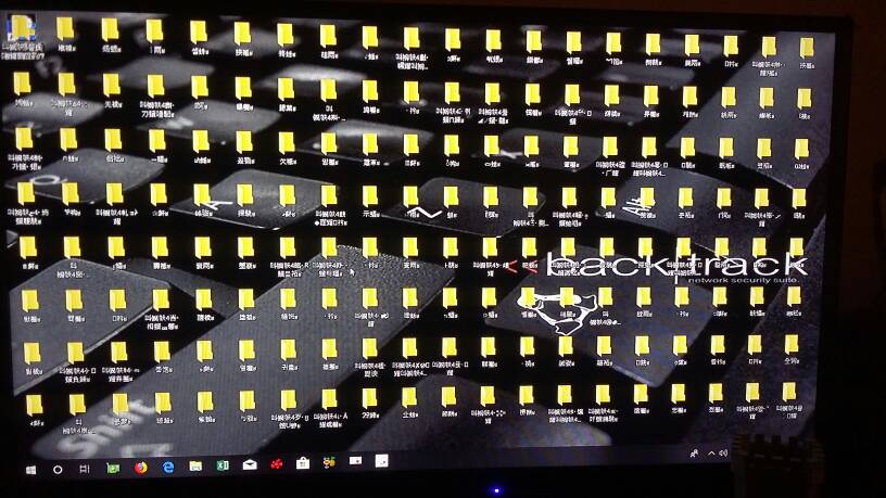

Computer froze, then 3 minutes later. This was on my screen....

I can't really read the directory names, but some thoughts about what it could be. (I've never seen a bug do this)
  • You accidentally did a select all/copy paste of directories somewhere to your desktop
  • Malware ( probably unlikely not much to gain from creating a bunch of directories)
  • Jokeware (don't know if that's a term but I'm using it) software that just does something silly like that
  • You extracted the content of an archive on the desktop
  • Some application had it's temp location changed to your desktop (possible if the %temp% environment variables were changed)
All directory names are in korean which i do not know haha. I know what you mean with yhe copy paste but The only thing i was doing, i was watching youtube, the video went blank, so i natuarally thought it was my gpu driver misbehaving, then pc froze up, then all of a sudden, 2532 directories were all there haha.
