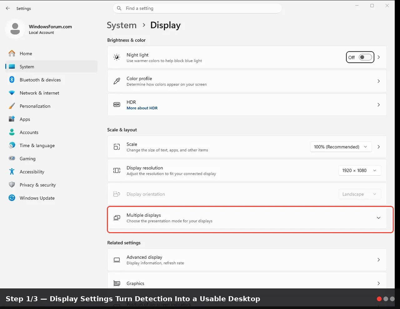

Display Settings Turn Detection Into a Usable Desktop
Open Start > Settings > System > Display. Under Multiple displays, select Detect if the connected screen is absent.
Detect asks Windows to check the display configuration again. Use it after verifying the basic physical connection and projection mode; it cannot correct an unpowered monitor or a cable connected to the wrong input.
If Windows shows more than one display, select Identify. A number appears on each active screen so the diagrams in Settings can be matched to the physical monitors.
Drag the display boxes until their arrangement reflects the desk, then select Apply. This is especially important when the pointer exits from the wrong edge, becomes difficult to locate, or appears blocked between displays. Windows follows the arrangement shown in Settings.
For example, if the physical external monitor is on the left but its diagram is placed on the right, pointer movement will feel reversed. Move the diagram to the left and apply the change.
The Display page also includes options to remember window locations based on monitor connection and minimize windows when a monitor is disconnected. These do not make a missing monitor detectable, but they can improve the transition between connected and disconnected configurations.
At this point, the decision tree should look like this:
- The display appears after Detect: Identify it, arrange it, and select Apply.
- The display was already detected but remained blank: Recheck Windows logo key + P.
- The display remains absent after a direct test and Detect: Reset the graphics session and restart Windows.
- The display works directly but fails after the dock is restored: Stop changing general Windows display settings and investigate the dock path.

Action Checklist for Admins
- Record whether the failure affects one monitor, all external monitors, only dock-connected displays, or only wireless displays.
- Confirm monitor power, the selected Input or Source, and the cable connections at both ends.
- Test another cable or compatible output where practical.
- Bypass docks, hubs, dongles, and adapters with a direct HDMI-to-HDMI or DisplayPort-to-DisplayPort connection where possible.
- Apply the gate works direct but not through dock → troubleshoot dock path.
- Press Windows logo key + P and choose the projection mode that matches the intended desktop.
- Apply the gate detected but blank → check Windows logo key + P.
- Open Start > Settings > System > Display > Multiple displays, run Detect, use Identify, arrange the screens, and select Apply.
- If the display remains absent after a direct test, press Windows + Ctrl + Shift + B and restart Windows.
- Apply the gate not detected after direct test → Detect, reset or restart, then driver recovery.
- Use the date of the failure to choose between driver update and rollback.
- Record the adapter name, driver version, and current configuration before uninstalling a graphics driver.
- If direct video succeeds but the dock path fails, test the dock’s connections and consult model-specific support information.
- For DisplayPort daisy chaining, verify DisplayPort 1.2 or higher and Multi-Stream Transport support.
- For wireless failures, press Windows logo key + K, remove and reconnect the receiver, and review its setup.
- Apply the gate wireless only → Windows logo key + K, remove pairing, receiver setup.
- For the Microsoft Wireless Display Adapter, use the app’s Update & security > Update interface before performing a 10-second reset.
- Document every successful cable, port, monitor, and connection path so the next action follows the result rather than repeating the same tests.
The Shortest Route Back to a Working Desktop
Use the hierarchy power and input → cable and direct connection → Windows logo key + P → Detect and Apply → graphics reset and restart → driver recovery → dock, MST, or wireless-specific repair, stopping as soon as the display works.References
