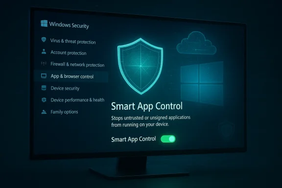

What changed: toggle, builds, and rollout
- The reversible toggle for SAC is included in Insider Preview Build 26220.7070 (packaged as KB5070300) and is being carried forward in later 25H2-stream builds. Microsoft published the Insider blog announcing the build and the associated changes. This is an official, documented change to SAC’s operational model.
- Where you’ll find the control in Windows:
Settings > Privacy & security > Windows Security > App & browser control > Smart App Control settings. From that screen eligible users can switch SAC between Evaluation, On (Enforcement), and Off. The new behavior is surfaced in Windows Security and thus is visible to ordinary users and admins alike. - Distribution model: Microsoft is pushing this as part of Windows 11 version 25H2 preview builds and is gating the change via Controlled Feature Rollout (CFR) for Insiders. That means you may see the toggle on some devices before others, and production release timing depends on Microsoft’s broader cadence. Community threads and news sites corroborate the build numbers and rollout notes.
- Important nuance: some coverage has referenced other servicing streams or earlier minor versions; the most authoritative signal is Microsoft’s Insider announcement and the Support FAQ, which emphasize the 25H2/Insider build path and the KB5070300 packaging. If a vendor or third-party article references 24H2, treat that as a reporting variation until Microsoft confirms broader availability.

How to safely test, disable, and re-enable Smart App Control — practical checklist
If you want to evaluate SAC or need to run an app that SAC blocks, follow these steps to reduce risk:- Check availability and current state
Open Settings > Privacy & security > Windows Security > App & browser control > Smart App Control settings to see whether SAC is On, Off, or in Evaluation mode. The toggle appears only if your device is eligible and the feature has been rolled out to your machine. - Prefer Evaluation mode first
Leave SAC in Evaluation when first available. It observes app usage without blocking, and if the system fits SAC’s profile it will move to Enforcement automatically. Evaluation reduces surprise-based breakage. - If SAC blocks a trusted app, don’t immediately reinstall OS
With the new toggle you can switch SAC to Off, run the app, then switch SAC back On. But follow the remaining steps before disabling. - Create a restore point and take snapshot backups
