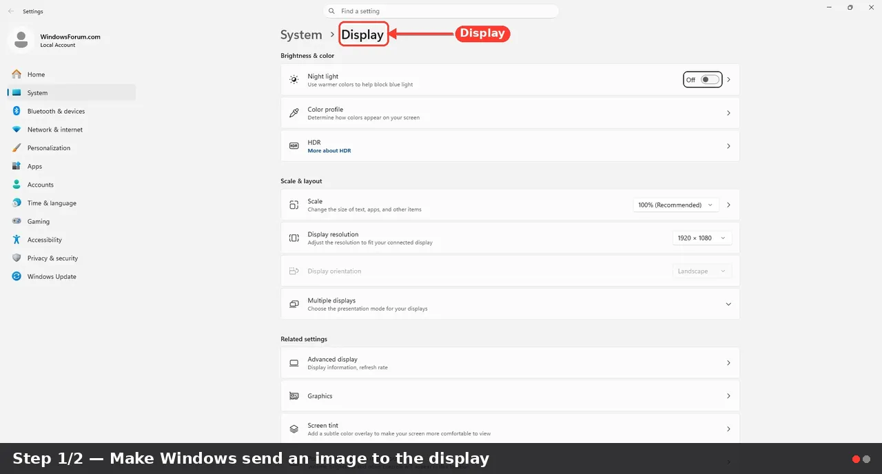

Make Windows send an image to the display​
Windows 11 Settings app on the System > Display page showing the Scale and Display resolution controls (a virtual machine has no brightness slider)
First press Windows+P. Select Extend if you want the DisplayPort monitor to be an additional screen, or select Second screen only if it should be the only active display. A PC set to “PC screen only” can leave a properly connected external monitor showing no signal.
If you cannot see the projection panel clearly, press Windows+P, press P again to move through the modes, then press Enter. Wait several seconds between attempts; Windows must apply the new display topology.
Next, open Settings > System > Display. Under Multiple displays, choose Detect. Microsoft includes this control in its external-monitor setup instructions for both Windows 11 and Windows 10. If Windows detects the monitor, select it and set a conservative mode first: its native resolution at 60 Hz. After it remains stable, raise the refresh rate in Settings > System > Display > Advanced display if the monitor and cable support it.
This is more than a cosmetic setting. High refresh rates and high resolutions demand more bandwidth, and a marginal cable, adapter, or dock can fail only at the more demanding mode. If a screen works at 60 Hz but disappears at 144 Hz, 165 Hz, or higher, treat the connection path as suspect before blaming Windows.
