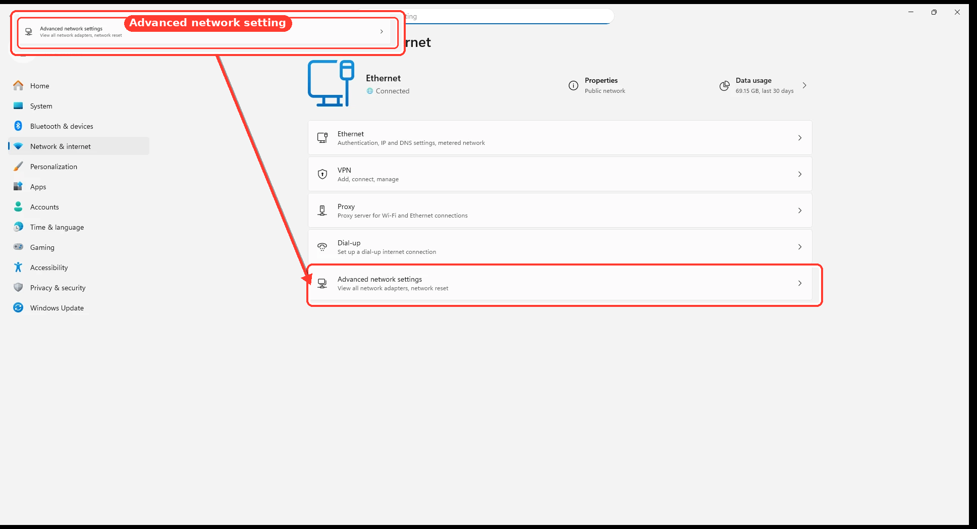

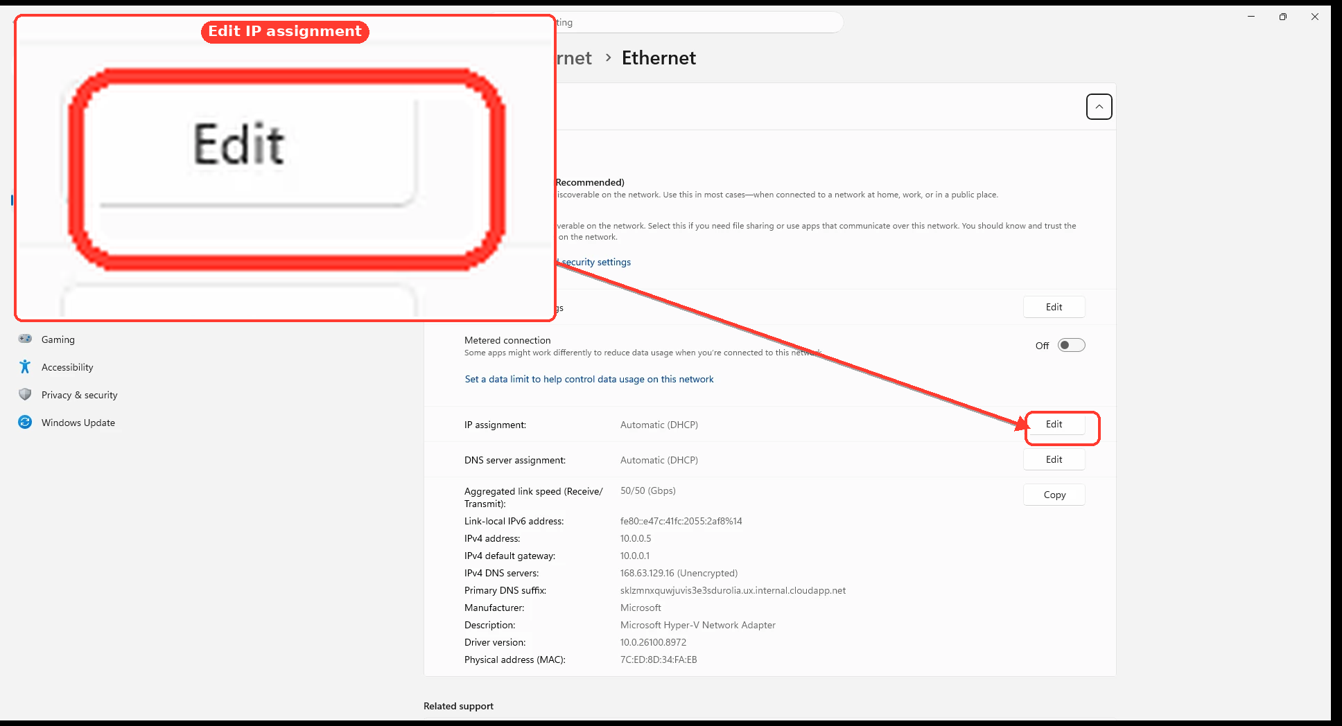

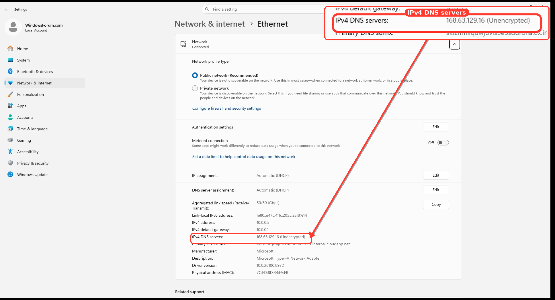

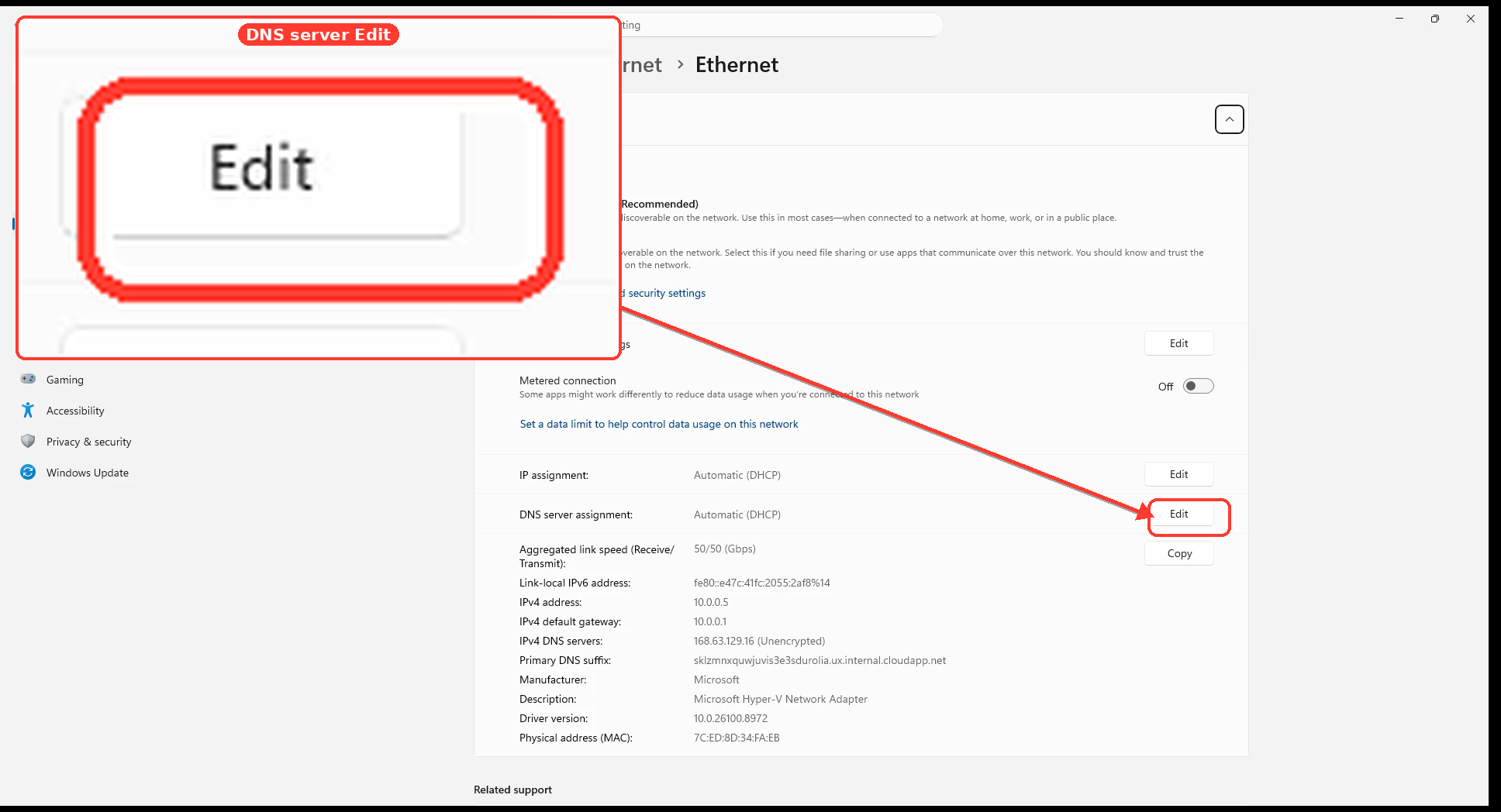

The following screens are Windows 11 references for locating comparable IP/DNS fields; Windows Server’s interface will look somewhat different:
