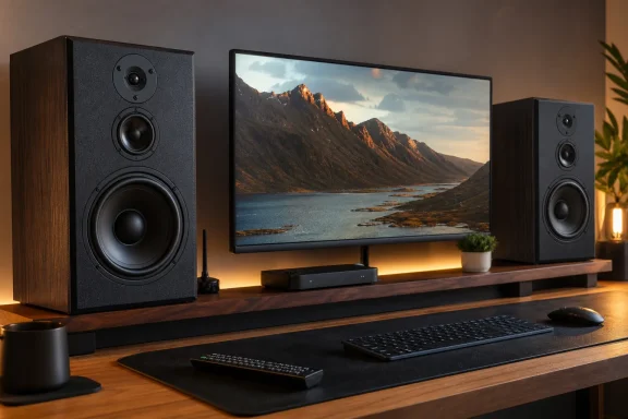

But the “best £300 PC speakers” framing needs an asterisk the size of the cabinets. Each speaker measures roughly 223mm wide, 395mm tall and 280mm deep; the pair weighs 16.57kg. These are not the compact powered monitors most PC buyers picture beside a 24- or 27-inch display. They are closer to small hi-fi loudspeakers that happen to include the electronics, and their placement will determine whether the purchase feels like an upgrade or a desk-management mistake.
A stylish home entertainment setup features a mountain landscape display between two large speakers.A three-way design changes the desktop proposition​
Most powered PC speakers at this price use a two-way arrangement: a woofer handling bass and much of the midrange, plus a tweeter. The R2750DB MK2 adds a dedicated 4.5-inch midrange driver between its 7-inch woofer and 1-inch tweeter. In theory, that gives the system more headroom to keep voices, guitars, game effects and dialogue distinct when bass-heavy material is playing.

The cabinet scale compounds the issue. To position the tweeters near ear height, many desk setups will need stands or risers. At nearly 40cm tall, a pair can block sightlines, crowd a monitor arm’s range of motion or push displays too close together. Digital Foundry managed them beside a 32-inch monitor on a 180cm-wide desk, which is useful evidence of feasibility, but it should not be read as a universal desktop-sizing recommendation.
