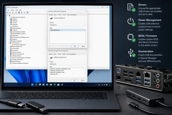

When that exchange breaks down, Device Manager may display entries such as Unknown USB Device (Device Descriptor Request Failed), Unknown USB Device (Set Address Failed), or Unknown USB Device (Device Failed Enumeration). Microsoft’s USB engineering documentation notes that these failures can arise when a port reset times out, the device does not accept an address, or its descriptor request fails or returns malformed data.
That is usually not a case of Windows merely missing an application-level driver. If Device Manager shows USB\UNKNOWN, or a vendor and product ID of VID_0000&PID_0000, the PC did not get far enough to learn what it was talking to. A driver download for a printer, keyboard, flash drive, audio interface, or drawing tablet cannot repair a device that cannot supply a valid descriptor.
The alternative is a recognizable hardware ID — something in the form USB\VID_####&PID_#### — paired with a yellow warning symbol and a Code 28 message. In that case, enumeration worked: Windows knows the manufacturer and product, but it cannot match the device with an installed driver package. That is where the vendor’s driver, Windows Update, or an OEM support package can be relevant.
To check, open Device Manager with devmgmt.msc, locate the affected item, open Properties, then select Details and choose Hardware Ids from the Property list. The information on that page is more useful than the generic “Unknown device” label.
