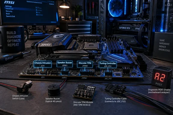

MSI motherboard workbench showing chassis intrusion, buzzer, TPM, tuning headers, and diagnostic POST display.

The larger issue is that motherboard manuals often expose the connector but do a poor job of telling buyers whether their particular board, chassis, or optional accessory can make use of it. XDA Developers examined an unspecified MSI B650M board and called out JCI1 chassis intrusion, JFP2 speaker/buzzer, JTPM1 discrete TPM, and JDASH1 tuning-controller connectors. MSI’s own manuals confirm that these labels and functions remain in use across recent AM5 and Intel desktop boards, although the headers are far from uniform between models.
The article’s most useful finding is not that these connectors exist. It is that a pin header printed on a motherboard is not a promise of a feature you can use. Before buying an accessory—or assuming a connector is dead weight—check the manual for the exact board revision and pinout.
