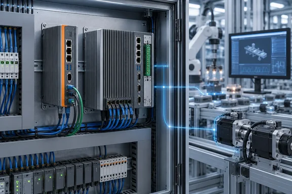

Industrial control cabinets connect to servo motors on an automated production line, monitored by a computer display.
OnLogic has added two industrial PCs built to run CODESYS as a software PLC. The Helix 521-PLC and Helix 524-PLC use Intel Core Ultra processors and ship with CODESYS-optimized Windows 11 IoT. The low-profile 521-PLC suits tight control cabinets, and the larger 524-PLC adds a PCIe slot that can take a Hilscher netX fieldbus card. LinuxGizmos reported the launch on September 22, 2026. Both systems follow the same idea: replace a dedicated PLC (programmable logic controller) with an x86 PC that runs deterministic control alongside other workloads, while keeping the real-time work separate from Windows. Choosing between them mostly means deciding whether you need hardware fieldbus offload and PCIe cards, or just a compact box with serial ports and digital I/O.
