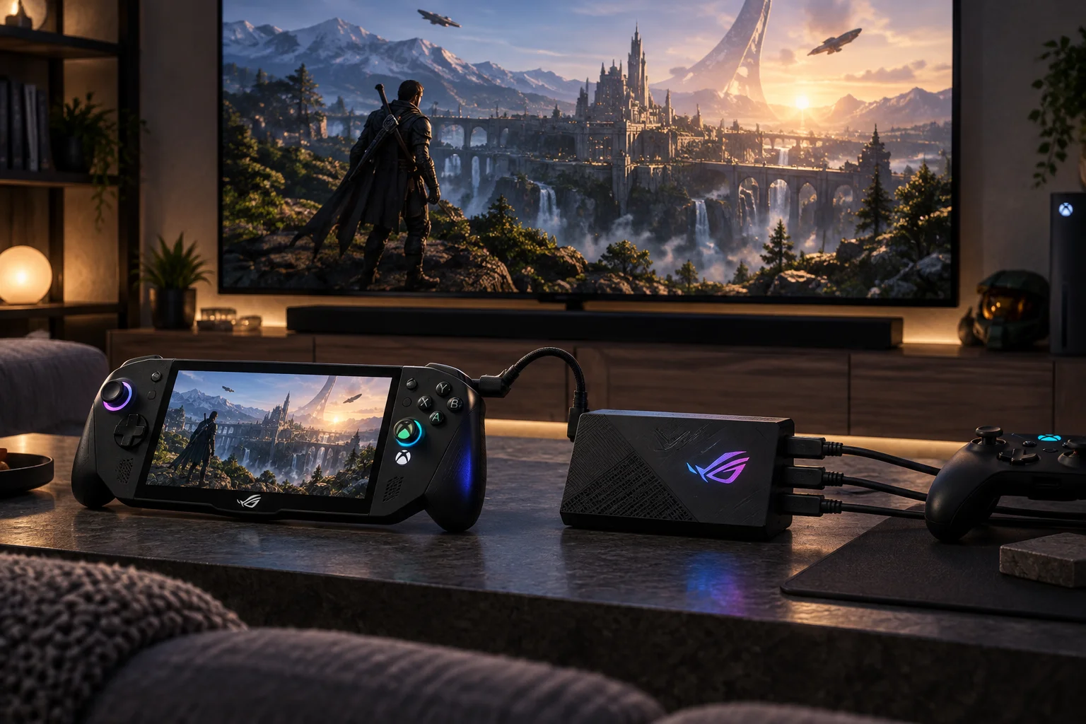

A handheld gaming device and controller connect to a compact console beneath a TV displaying a fantasy adventure game.

A handheld gaming device and controller connect to a compact console beneath a TV displaying a fantasy adventure game. Inside the 6-in-1 Port Layout and Power Delivery​
The phrase "6-in-1 connectivity" gets thrown around loosely in the USB-C accessory market, so it helps to examine what ASUS actually counts on the chassis. According to the official ROG technical specifications and support documentation, the six integrated ports on the DG310 break down into one HDMI 2.1 video output, one Gigabit Ethernet (RJ-45) port for low-latency wired networking, three USB 3.2 Gen 1 Type-A ports, and one USB-C power-input port.
To connect the dock to the handheld itself, the DG310 uses a fixed 60-centimeter (roughly two-foot) upstream USB-C cable fitted with a 90-degree angled connector. That right-angle plug is a practical touch for top-mounted handheld USB-C ports, keeping the cord from jutting awkwardly into the air or straining the port housing. Because that upstream cable is permanently attached, it is separate from the six selectable ports on the body of the dock.

Physically, the DG310 is built as a cradle as much as a port replicator. Finished in black with classic ROG styling, the dock incorporates an angled stand engineered to hold the handheld upright without obstructing either the screen or the rear cooling intake and exhaust vents. While ASUS states that this ergonomic design maintains unimpeded airflow, readers should view that as a structural clearance design—keeping vents uncovered—rather than an active cooling accessory.
