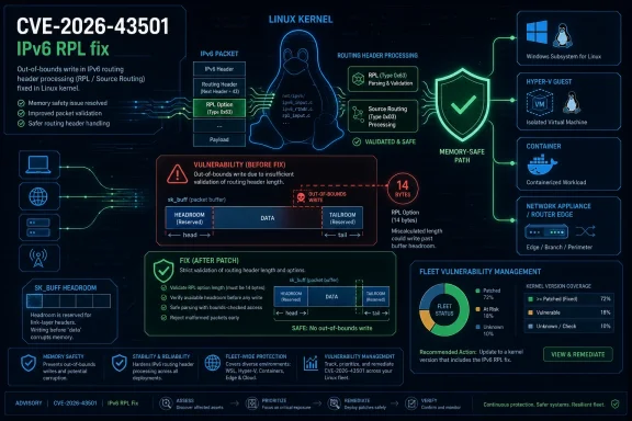

Cybersecurity infographic showing Linux kernel CVE-2026-43501 IPv6 RPL fix with memory-safe patch flow and stats.A Kernel Corner Case Becomes a Fleet-Management Problem​

The CVE description says the issue was resolved by changing how the kernel reserves headroom when a decompressed and recompressed Source Routing Header grows. In plain English, the kernel was rewriting packet metadata and data structures under an assumption about available space. Under a crafted packet shape, that assumption breaks.
The reported failure mode is concrete: a crafted IPv6 raw packet over the loopback interface can drive the packet buffer into a state where rebuilding the MAC header causes a small out-of-bounds write far away from where the kernel intended to write. KASAN, the kernel address sanitizer used to catch memory bugs, reportedly flags a 14-byte out-of-bounds write in the IPv6 routing header receive path.
That is not the same thing as a public weaponized exploit. But in kernel security, a reproducible out-of-bounds write is not a bookkeeping mistake. It is the kind of primitive that forces maintainers, distribution vendors, and security teams to treat the affected code as potentially dangerous until proven otherwise.
The Bug Is About Headroom, but the Lesson Is About Assumptions​
Linux networking is built around the sk_buff, or socket buffer, a structure that carries packet data and metadata through the stack. Network code often needs to push and pull headers as packets move between layers, tunnels, routing logic, and transformations. That machinery depends on there being enough space before and after packet data to adjust headers safely.
CVE-2026-43501 is a failure in that accounting. The vulnerable path decompresses a Source Routing Header, swaps the next segment into the IPv6 destination address, recompresses the routing header, then removes the old header and pushes the new one back with the IPv6 header. The recompressed result can be larger than the original header.
That detail is the trap. Compression sounds like it should reduce size, but this code is not compressing an arbitrary file; it is encoding IPv6 address segments relative to shared prefixes. When the swap changes how much prefix is common between the destination and segment addresses, the recompressed routing header can grow. The description gives a maximum growth case of eight bytes.
Eight bytes is small enough to look harmless and large enough to break a kernel invariant. The prior expansion check was gated on segments_left == 0, which meant earlier segments could consume headroom without ensuring enough room remained for the MAC header rebuild. Once the front of the buffer had less room than skb->mac_len, a negative offset stored into a 16-bit field could wrap, and a later memory move could land roughly 64KiB away from the intended buffer head.
This is the kind of vulnerability that makes kernel engineers sound superstitious about “just a few bytes.” In userspace, an eight-byte miscalculation may crash a process. In kernel packet handling, it can corrupt memory in a privileged context reached by input data.

The Fix Is Small Because the Broken Invariant Was Precise​
The proposed remedy is conceptually straightforward: expand the packet head whenever the remaining room is less than the push size plus mac_len, and request enough extra room so the rebuilt MAC header fits afterward. In other words, make the buffer accounting match the worst case rather than the expected case.
That is the right kind of kernel fix. It does not try to ban a strange packet shape after the fact. It repairs the invariant that packet transformation code depends on: before pushing headers and rebuilding metadata, reserve enough room for both the new header and the link-layer header bookkeeping.
Small patches in packet-handling code can have outsized security significance. The bug is not that Linux supports RPL. The bug is that the stack allowed a legal-ish transformation path to proceed while silently eroding the headroom required by later code.
