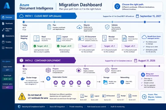

V4.0 Is the Default, Not the Universal Container Replacement
Microsoft recommends the v4.0 API version2024-11-30 for new development, and the current SDK generation defaults to that version. That makes v4.0 the sensible starting point for cloud modernization and for container workloads whose model is already available.Container support is narrower than cloud API support, however. Microsoft’s current matrix lists:
- V4.0 containers for Read and Layout.
- V3.1 containers for Read, Layout, ID Document, Receipt, and Invoice.
- V3.0 containers for the broader set that includes Read, Layout, General Document, Business Card, and Custom models.
A v2.1 Read or Layout container is a direct candidate for v4.0 evaluation. Administrators still need compatibility testing, but there is no model-availability reason to stop at v3.1.
A v2.1 ID Document, Receipt, or Invoice container cannot simply be reassigned to a v4.0 container because those models are not in the current v4.0 container set. For these workloads, v3.1 is the available newer container generation listed by Microsoft.
Business Card, General Document, and Custom container deployments require additional care. The documented v3.0 container generation has the broader model coverage, while the newer v3.1 and v4.0 container sets do not provide every one of those models. Administrators should not interpret the August deadline as evidence that every workload has a feature-equivalent v4.0 image.
This creates a two-track policy:
- Move eligible Read and Layout containers toward v4.0.
- Place workloads requiring ID Document, Receipt, or Invoice on v3.1 while monitoring Microsoft’s v4.0 container expansion.
- Treat Business Card, General Document, and Custom deployments as model-specific architecture decisions rather than routine version bumps.

The September 2027 Date Is Not an Extension for Containers
The most dangerous planning error is attaching the Document Intelligence v2.1 REST API date to a v2.1 container. Microsoft lists September 15, 2027 for the v2.1 cloud REST API, but the v2.1 container is named separately on the lifecycle page with support ending August 31, 2026.An internal asset labeled “v2.1” is therefore not classified well enough. The inventory must say v2.1 REST API or v2.1 container, along with the model being used.

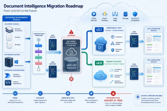

Make the Cutover Reversible
The remaining time before August 31 should be used to remove uncertainty, not to schedule a single in-place production upgrade. Stand up the selected v3.1 or v4.0 target beside the legacy deployment, replay representative documents, and compare outputs before changing callers.Where possible, separate client changes from container changes. First make the application capable of selecting an endpoint and handling the new contract; then redirect a controlled share of traffic. Keep rollback bounded and temporary, because restoring a v2.1 container after August 31 would not restore Microsoft support.
Operational documentation must change with the deployment. Update image references, API-version settings, model mappings, secret names, health checks, dashboards, alerts, recovery procedures, and support runbooks. Remove obsolete v2.1 manifests and cached assumptions once rollback is closed so that the retired generation cannot quietly return.
The August 31, 2026 retirement is ultimately two deadlines sharing one date, not a blanket shutdown of Document Intelligence v2.1. Administrators who identify the execution model and document model separately can move Read and Layout directly toward v4.0, use v3.1 where current container coverage requires it, and avoid forcing unsupported workloads into a migration path chosen only because it has the highest version number.
